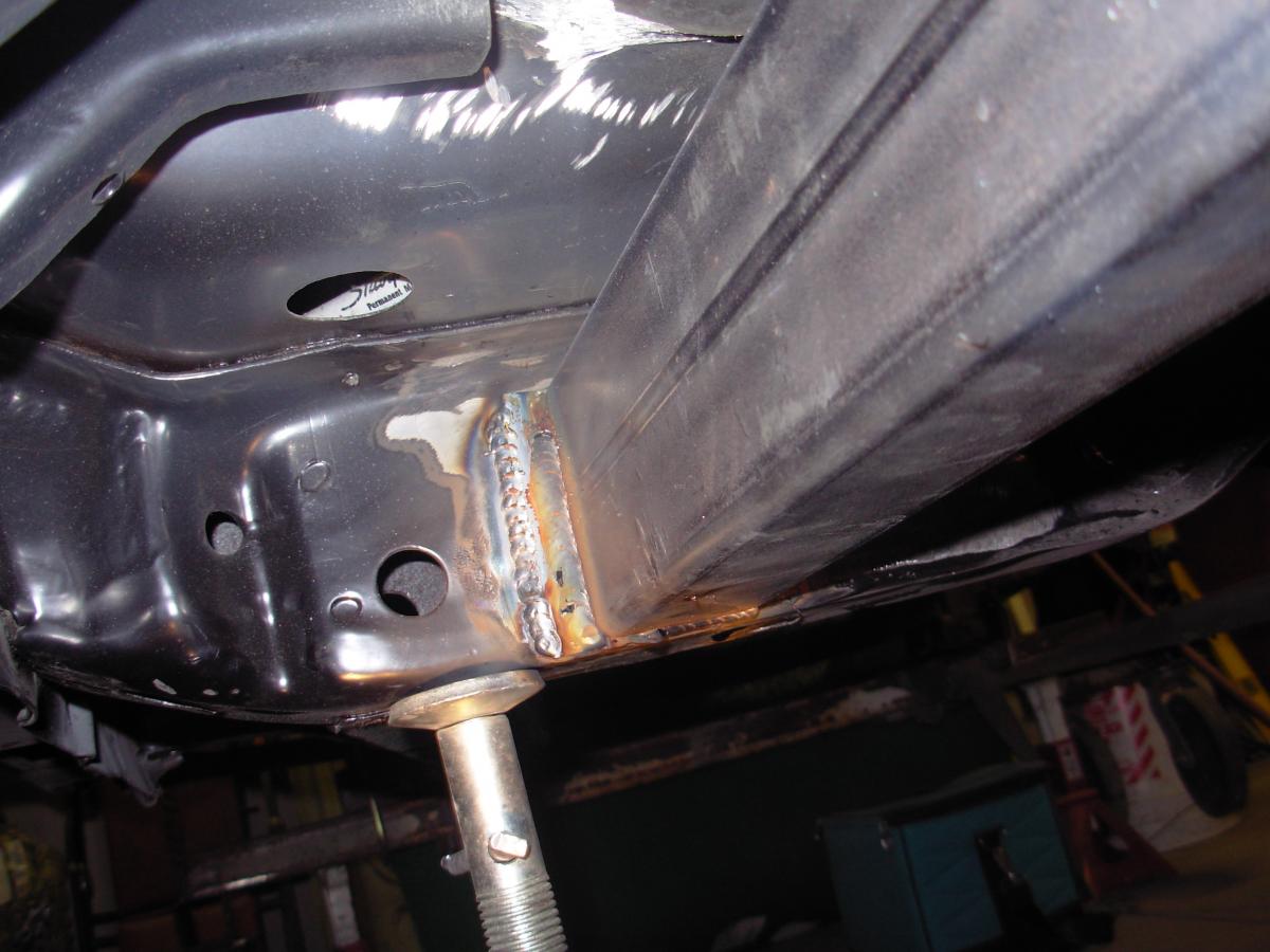

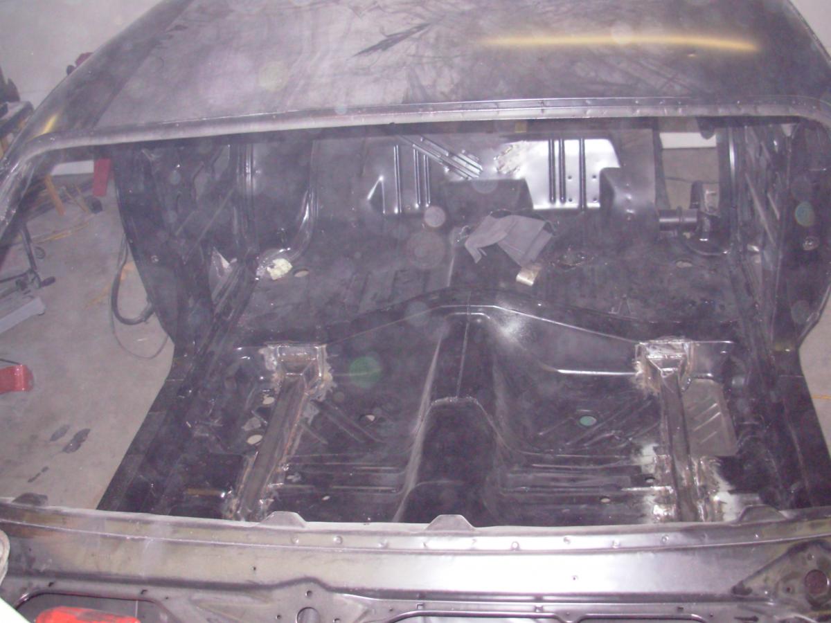

Some say the weight of the car should be on the ground, some say it doesn't matter. When I put mine in, it was just a shell and on jackstands, also used thin sheet metal as shims to get it level. I put the stands on threar frame rails and on the front rails about 2 feet off the ground and went to town. Use the stands so you can shim if/where needed.

5.7 hemi has been the closest to being correct.If the car is complete with running gear,the weight of the car must rest on the tires.Level the car using shims under the tires.Using a four foot level,level the car using the pinch welds almost always.Check your panel gaps in the process and readjust the panels before you proceed.
Empty shell set up on jack stands and level.Set the jack stands on the subframes at the crossmembers.This means at the torsion bar crossmember and front spring perch area.I also use screw jacks for ease of leveling and a set of regular jackstands for safety.Saying all this I assume the vehicle is in good structural shape.
