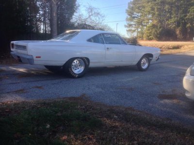

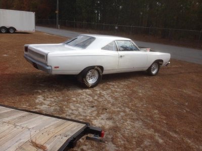

This is all good stuff. Thanks to you all. Here's what I did. I installed 2 inch lowering blocks, removed the 1 short stiff leaf on the driver side & both short leaves on the pass side. Car now sit 2 9/16 lower in the rear & is near level on the rear. The front went up 1/4 inch. Did a few dry hops on the driveway at only 1200 rpm launch & now it really lifts the left front & squats the right rear. Was almost violent. May have to put those leafs back in. But for now I think I am going to do s TNT just to see how it does. The pic of the car in my driveway is after I lowered it
You do not want the right rear to squat. What is happening after the initial hit the axle housing is being pulled into the body and away from the pavement. The reason the R.R. sets higher with SS springs is that it will be loaded harder. Raising the rear also raises the center of gravity allowing easier pitch rotation. So what you have done is remove pitch rotation and made the R.R. spring weaker. My bet is if it has enough power that it will spin right after the hit and want to drive towards the right at the starting line. Let us know.
Doug
Doug
Doug you are right. I completly agree. However my rear shackle was almost 90 degrees. Now after thd changes it is more to normal looking. I think I am going to try it like this at a TNT. I may also try to stiffen the right rear shock to controll the squat. Again my drive way is not a fair comparison to a track. I can always reinstall parts removed. I may also unclamp the back of the leaves. I will let you know how the car responds. It ain't got much power.
the reason we did this is to let the rear work better it worked best with adjustable pinon snuber 1 in clearence the front part of springs acked like soild traction bar.
Yep I have the adj snubber. I took it off because the SS springs had the rear raised so high it was not needed. Keeping it with me so when I get a chance to make a few passed I can try it both ways. Had some time to think on this & the comments & believe I should have left those small leafs in. But still Going to make a few hits just to see how the car responds. Can easily put them back in.
Well I took the car to a TNT today. I made 3 passes. All the the 60 ft was 1.89 my 330 foot was 5.51, 5.51 & 5.49 as it was getting cooler. My ET was 8.59, 8.58 & 8.56 Staged shallow at 1500. Instead of 1900. Car launched good & straight. No burn outs. 2 dry hops each pass. So I think my changes worked. I need to go to a different track soon & see if it's as close. I think I can manage with those numbers & win rounds. Happy Boy ! Hopefully the photogropher took some of my car so I can see how it came off the line. There was a lot of cars there ( guessing 100) so the track prep was very good
