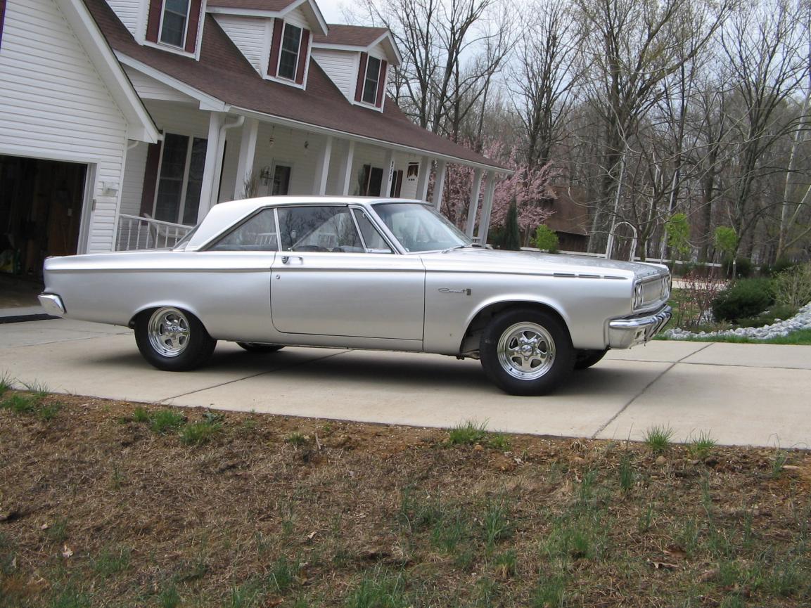

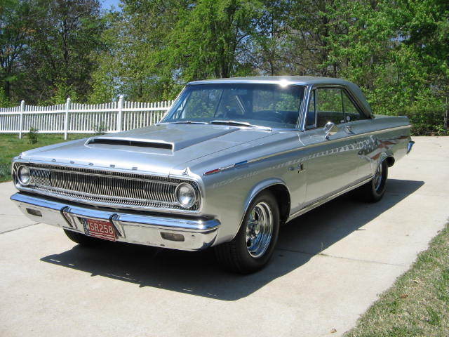

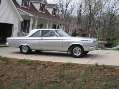

The first pic with the A990 grille and scoop is what I had before changing to more of a "sleeper" look, just finished, as shown in the second pic. Still thinking about torque thrusts or steelies with poverty hubcaps to replace the prostars. Since the second pic was taken after paint, I have converted to a 4 speed, repainted the engine the proper turquoise color, and installed manifolds in place of the headers. Anybody looking for a 1965 BB 727?

Wedgie, very sharp looking Coronet!!!!
Nice Ride. What are you running for rear tires and backspacing?
The rear tires in the pics are Mickey Thompson N-50's. I recently purchased a pair of Mickey 12.5X29's which will give a bit more height and keep the section width at about 14". The prostars are 10" with the smallest backspace available. I had the housing shortened and axles made at Moser Engineering. The car is mini-tubbed and the springs are moved into the longitudinals. Still want to change the wheel setup for the look that I am now after.
