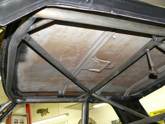

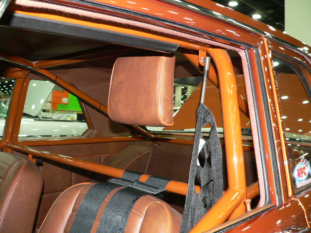

I made my own steel plate welded to a tube. 2nd tube welded to the cage
with a tee. One slides inside the other . has a bolt hole through both so it can be adjusted.
Doug
