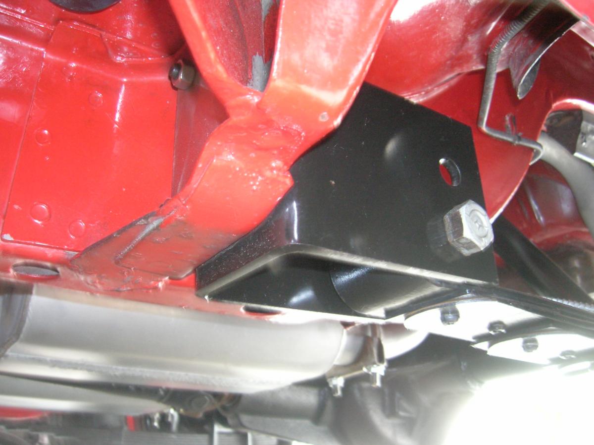

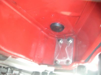

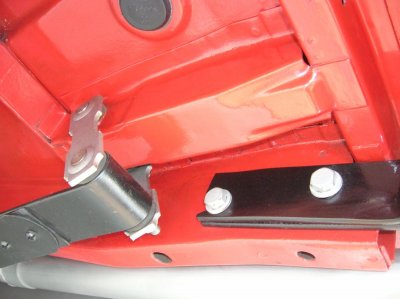

Front Mount for SS springs
Here is a pic of the front brkt I used for my SS springs .I used a reinforcement plate behind the brkt . and there is a pic of the shackle position wheels hanging on jack stand . Hope this may help .
Thanks for the pics Don
