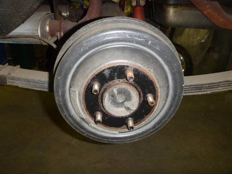

So I have another question? I took the springs and rear out today. When I took the wheels off there was one finned and one plain rear brake drum. Was wonder with an 8 3/4 in the Bird what style was used? Thanks
10" or 11? My original 10" drums. Generally front disc and 10" rear drums...
10" rear, front disc, Hemi, auto, 3.55 8 3/4. Also has a piece of steel welded in where the pinion snubber would hit the floor, like a reinforcement pc?
I believe that's all correct for your car.
The Rear brake drums, are the finned or smooth edge?
thanks your right, i missed the picture. thanks for all the info
