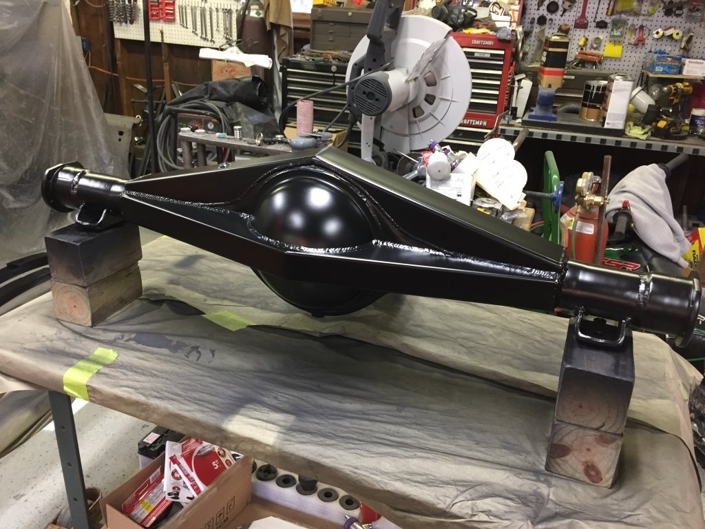

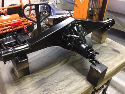

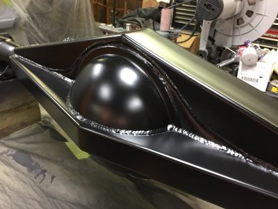

what I'm running! 8 3/4, Detroit Locker, 4:10's, Back and Top Braced, Moser Axles. I've also heard that the housing fails first so I tried to do my best by boxing it in as best I could. Car making almost 700hp and should run low 10's but I'm still hopeful for the best. I bought this rear already together and kinda cheap, then braced it myself but if I were to do it from scratch I would have probably went Dana.
The clutch style will last a long time, just remember that back in 64-65, the Dana 60 was not available and you had max wedges putting down some serious power.
