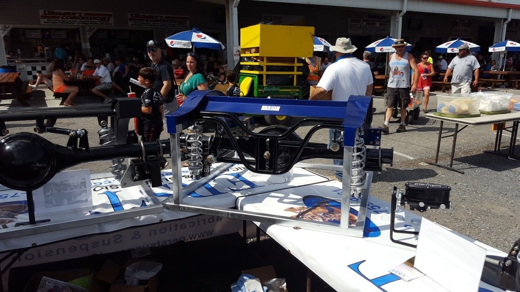

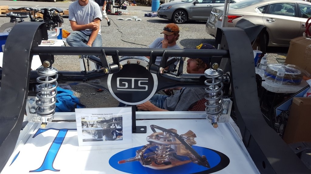

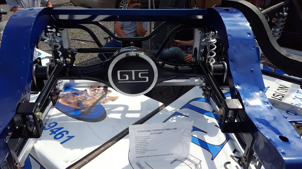

If you must, call Carl Gerst.
He can make anything you want.
20160715_160109.jpg 20160715_155939.jpg 20160715_155926.jpg 20160715_155917.jpg

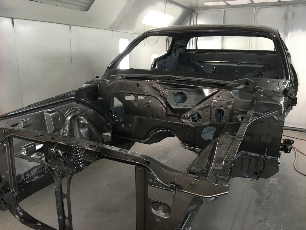

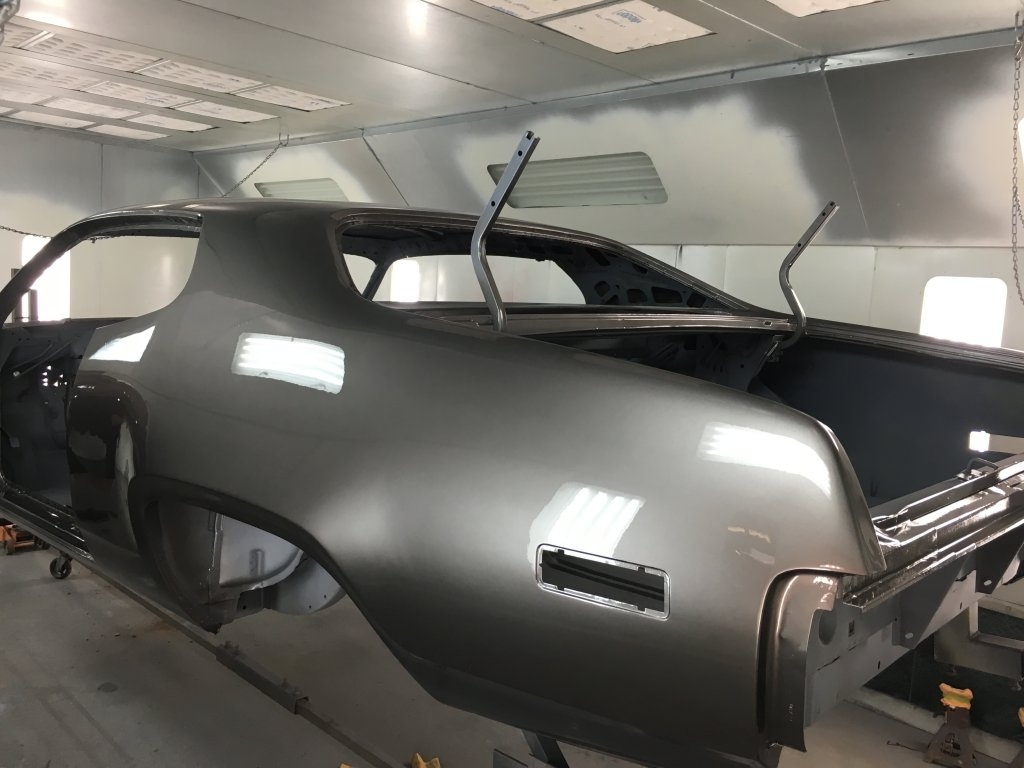

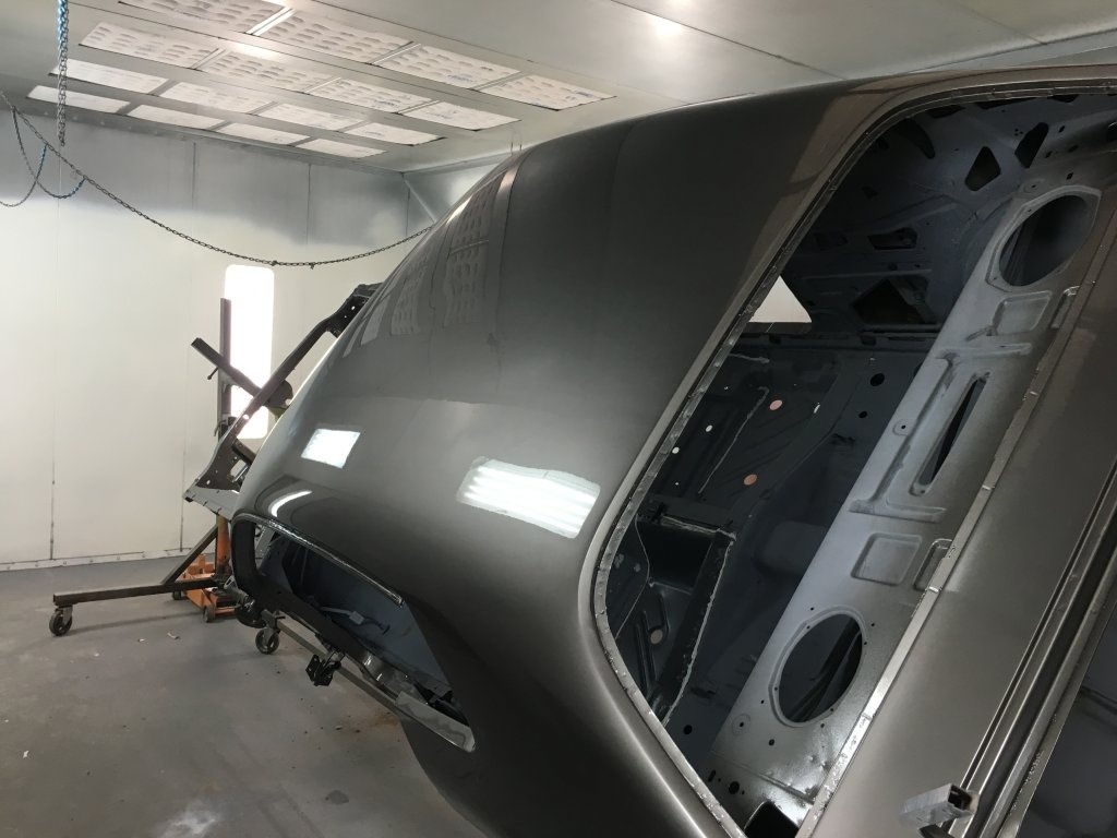

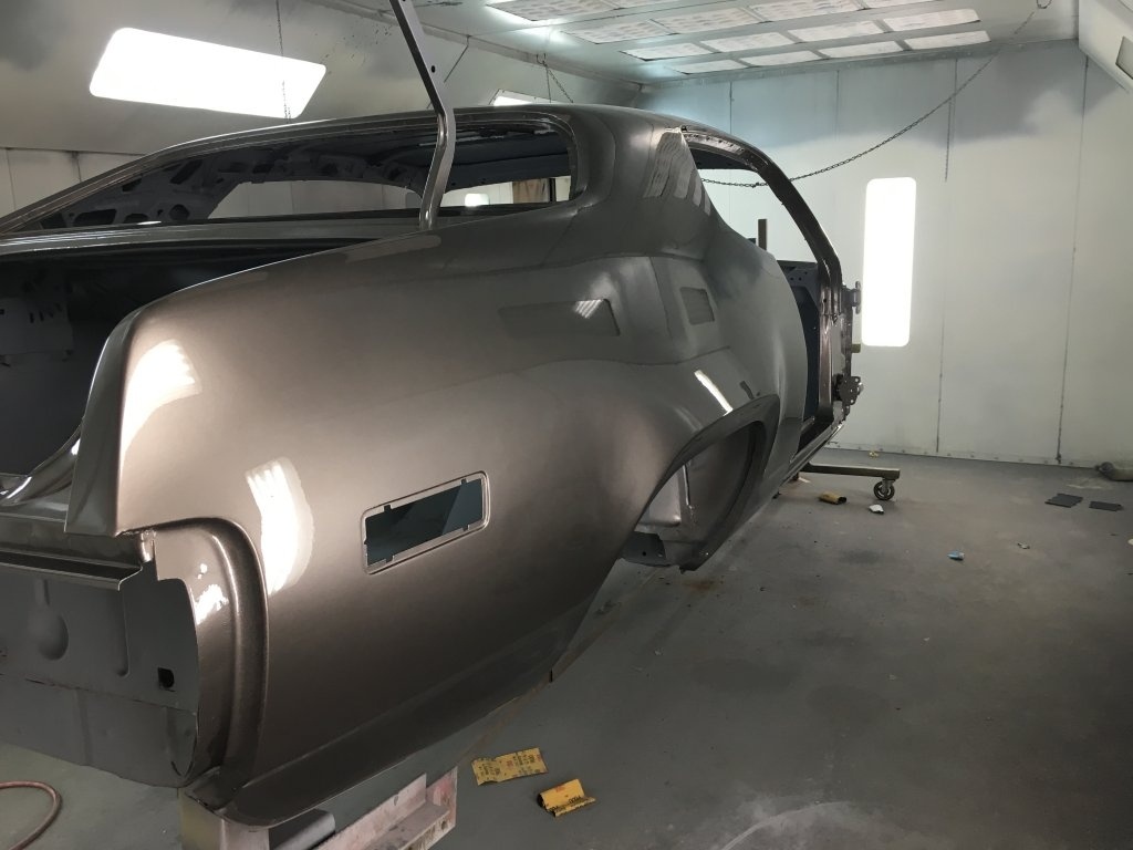

The GTX had the torque boxes from the factory (upgraded the front ones), but I still need to choose the subframe connectors. My budget is pretty tight as I put most of it into the body and motor. I was planning on breaking down the old leaf springs this weekend, but all these comments have me thinking the Caltrac option is the best route along with a slow upgrade of the front to the QA1 setup. Thanks for all the input. You guys are awesome. Here are a couple pics of
the GTX in paint !!

BTW, the car looks great; love the color.
