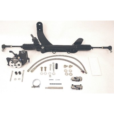

Also have a steering dilemma. Since its a drag car the steering is manual. Is it possible to get away with manual steering? I'm thinking not so am looking at OEM style power steering boxes but trying to limit cost.

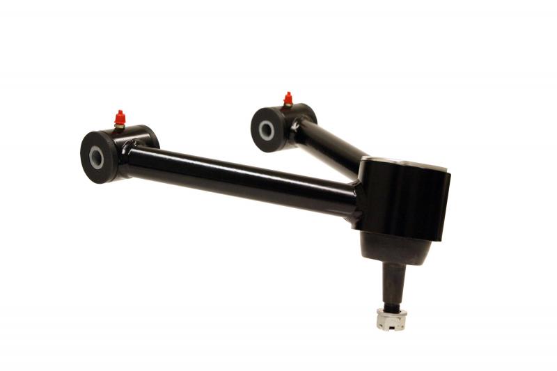

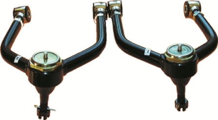

I did go with SPC Upper double adj. tublar control arms instead of the QA1's
they were adjustable on the car, much easier for fine tuning...

I went to a Unisteer Rack & Pinion {Omni style}, it's like $1000 for power steering
& I personally would NOT recommend it, albeit I do like it now,
with some bump steer corrections & I was going to custom built headers anyway,
but it really limited on "out of the box/off the shelf" headers & oil pans etc.
I'd do the Flaming river quick ratio box or even the Borgeson box IF I was to do it over again
or just do a front steer style like a Mustang II fab up a different shaft,
make more room for headers & bigger FC style pan...
