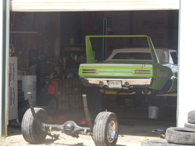

im doing this exact swap today i will take some pictures and post them
