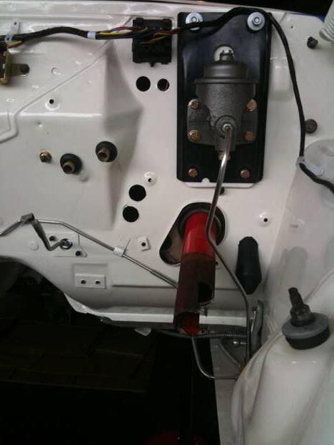

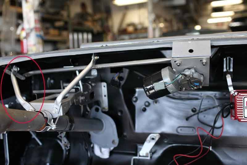

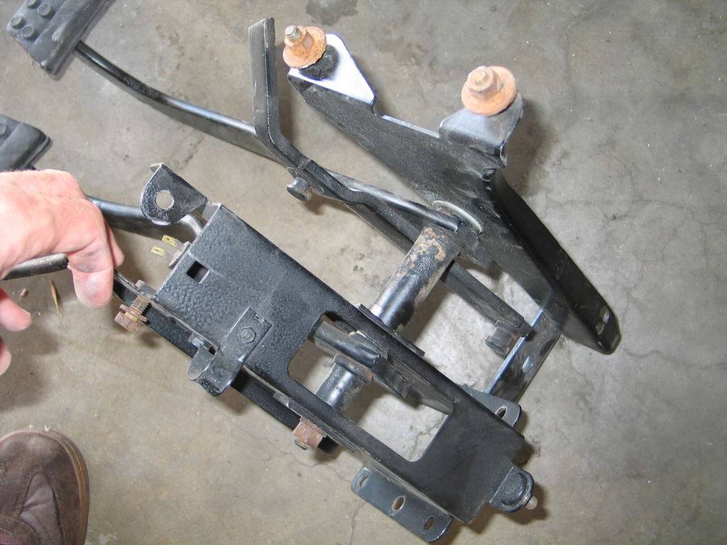

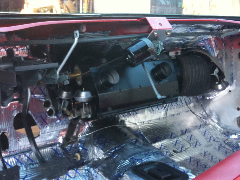

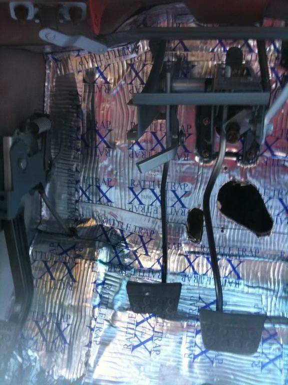

If it helps, here are a couple shots of my 64's clutch and brake setup.
Here you can see which bolts go through the firewall:
