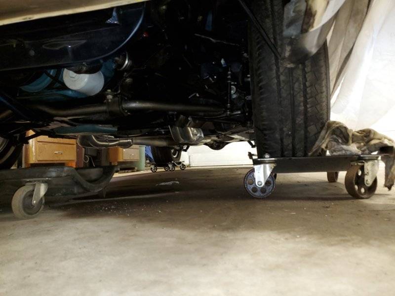

I just installed a Hellwig bar on my 64 that I bought from summit. Nice product and heavy duty brackets, etc. I decided on a 1 1/8 solid bar and hope to try it out as soon as the snow is gone.

Nice look8ng sway bar did it come with all the hardware needed to attach to the lower control arm?
All the brackets necessary are included. It's a little tricky to get the bar centered and the end links positioned correctly so that the bar bushing brackets can be spotted to drill the Kframe. The center rad support brace is tight to the bar and I'll need to add spacers to lower it for clearance.
