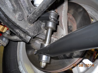

Is an aftermarket sway bar available and in a stock type set up? I've looked around but haven't found anything pre 66.
Firmfeel makes a couple for the 63. Pictures show my install. The angle tabs attach with the shock mounting bolts. Works great.
: DSCN3742.JPG
