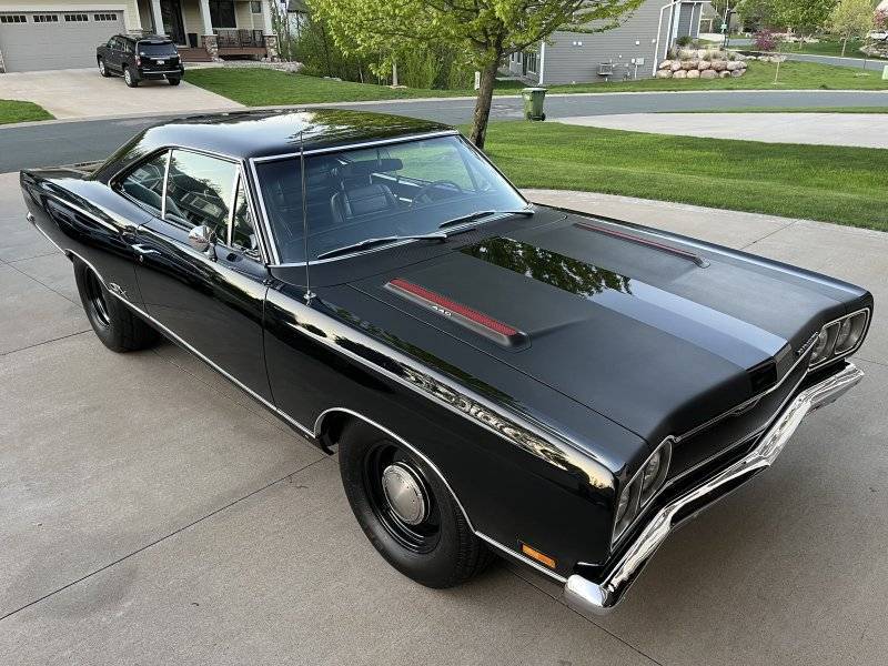

I do like black cars but the paint maintenance to keep really nice is difficult.
A friend of mine painted a 68 Charger black and he has the same problem as you.
