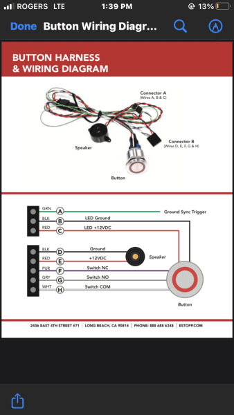

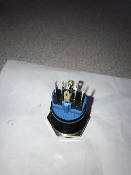

I Ordered a Switch Online For My
E-Stopp Emergency Brake. Just Wondering If Anyone Can Explain How To Wire It?

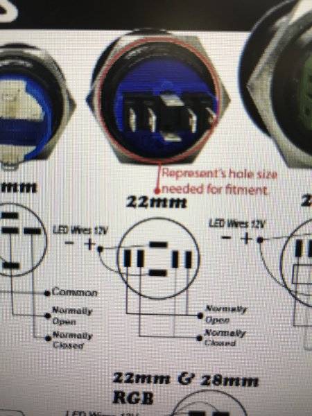

Looks like red and black are power for the LED and the other 4 are either normally open and normally closed. The common I see looks like its on another style switch. Not the one you have. Both your old and new switches are the same. Look at the pinout on the one on the left. Its nothing like the one you have. As long as you have ground going to ground and hot to hot. The others just need to go where they came from.
