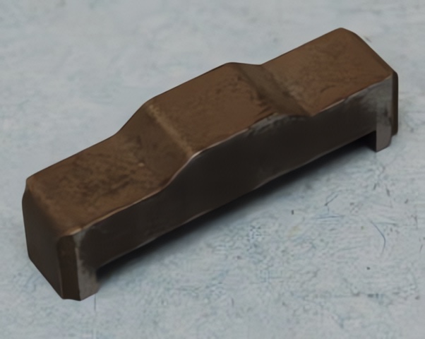

I’m rebuilding my trans for my 69 roadrunner and one of my synchro keys is broke! I’m having trouble trying to find the one I need all other years except for my year!! Brewers says out and another site says NLA!! I’m going to give Dan Brewer a call after the break but I’m not sure how far I will get!! Anyone know how to find this stupid little part haha!! Thanks

I'm surprised he didn't tell you to replace the entire synchro unit for the new style, I've done several of them. Must be replaced as a complete assy.
1-2 is listed for $170
3-4 lists for $150
Both at Brewers
Btw, Passon lists synchro keys for $10
He's a good dude.

Ahh yeah I guess I didn’t think of that haha!! Yeah I’ll put in a call to Dan on Thursday!! Thanks very very much
Just to confirm what you're looking for - you're looking for the narrow key that has a large hump in the center of it? I may have some spares in the shed -
