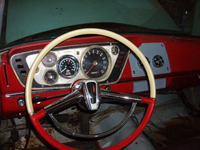

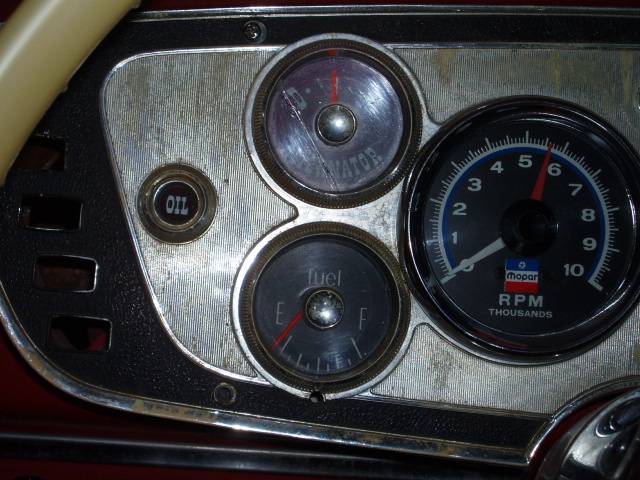

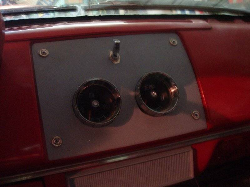

I went a slightly different route with my '63 330 (It's a Canadian Dodge hence the Plymouth Dash) I removed the Temp and Fuel gauge from the cluster and installed the tach in their place. I then used a fuel gauge from a '62 and installed it where the clock would normally go. The Temp and Oil pressure gauges are in a panel that replaces the speaker screen (which was sunbaked crisp anyway) . I am not installing a radio of any type so no issue that way as I've installed the correct radio delete plate. The auxiliary gauges are from a 1958 Dodge Custom Royal and work very well. My tach is a Direct Connection tach P/N 3514430. I have a few extra instrument clusters so if required I can go back to stock. (I have to send one out for replating etc.) I believe the speaker screens are being reproduced but I'm not sure as yet by who. I did this simply because I do not like the Tachs and any auxiliary gauges hanging off the dash and all that. The tach is also right in front which helps when shifting. (I built a reverse pattern manual shift Torque Flite) .
I like the idea of having it in the gauge cluster, as I have the clock blank there. Pulling the speaker grill is an option, but I really like the stock dash look. If racing was my cars design, I wouldn't hesitate on that. I wish I would have thought of it during the build, and with everything together, and trying to end this 7+ year project, I can't justify pulling it apart now. My time is getting short...

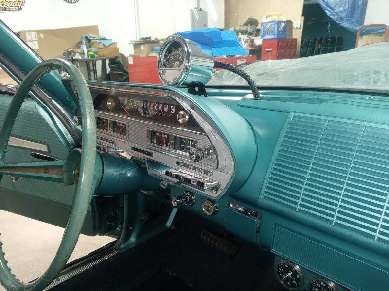

Well, I couldn't come up with anything else, so it went on the dash shroud. Took the day to locate drill, tap, mount, in & out about 3 times, tweaking, etc...
Looks great in that position. Your ride is a great work of art.
I finished the wiring today, not quite what I wanted, but I didn't want to cut into taped harnesses. I can dim the gauges with the dash light switch...
I guess that ends this thread. Thanks to All that had some Input, makes things go better, when you have some Backup !
Enjoy the ride. Job well done enjoy
