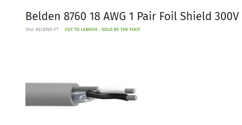

In the US it's called shielded cable.
Good point!!
We use the Belden foil alot for sensitive audio circuits. It has the traditional copper braided shield and all wrapped in a foil shield,
provides excellent shielding for interference from close by components.
Just my $0.02... :thumbsup:
