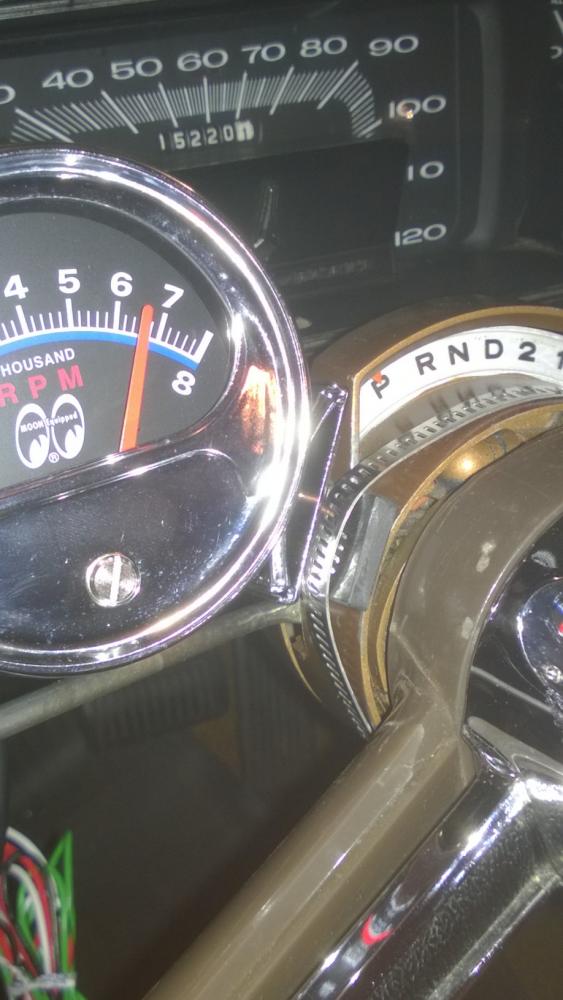

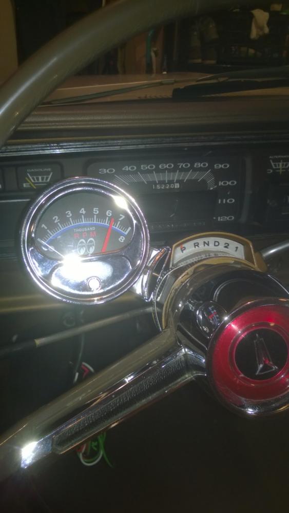

Here my column install on a 66 Belvedere I column shift. I made an aluminum foot to mount the tach mount too, then some thin foam between the aluminum foot and column. It stays put for now. tach_mount.jpgtach_mount_2.jpg

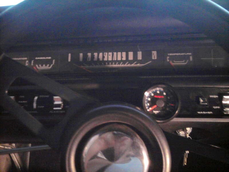

Just get a smaller tach, like 2" or 2-5/8", put it in an autometer gauge cup and strap it to the column toward one side. It won't block a thing.
Like so...
having gone thru this with my '65 coronet i can say that there isn't a good solution. the way the steering column is situated in relation to the instrumentation is the problem. my '69 r/t will allow for a 3 3/4" tach on the column but the '65 won't, even with a special bracket i fabbed, without interfering with the instrumentation or dash knobs. the only "solution" i see is the bracket i made with a 2 5/8" tach that my 66 yr old eyes would struggle with. moving the column in and out helps slightly but for now i just tossed the 3 3/4" tach.
