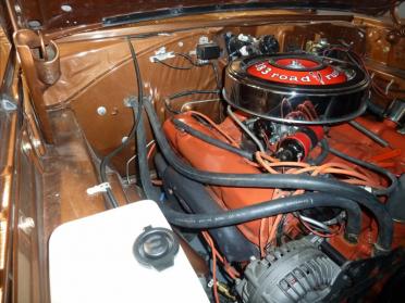

I got some repops for my 69 RR but don't recall the actual company. Can't be more than one or two suppliers so shouldn't be hard to find. I paid $350.00 / pr and they are very nice. The guy made a comment that they are priced right about that same as having them rechromed.

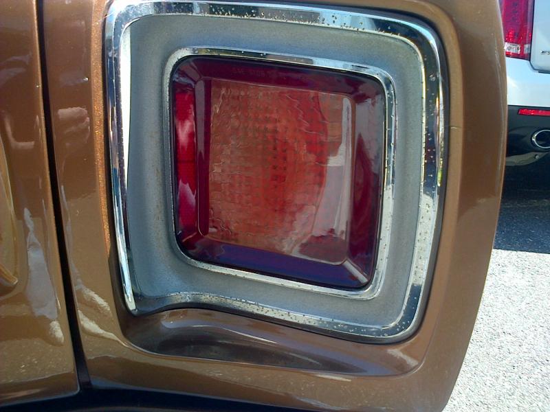

5 days to get here…it was just above north dakota in canada…..i have to do the r/s one for sure….not horrible but it jumps out at you…i'll probably pull them off as soon as it gets warm around here and see what a i can do with it….maybe the repro is the way to go? Any problems with fit on the repros…or do they seem to be pretty close?

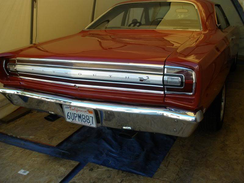

I think they fit well enough. I don't have a close up pic but even from this one they look good.

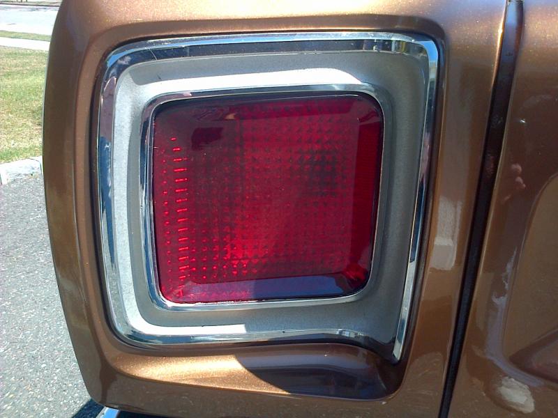

There's a local shop to me that does awesome chrome work on potmetal. They did my vent window frames because those were pretty bad. For my taillight bezels I had another shop just rechrome and not worry about what little pits are present since most of the chrome is painted over with argent anyway. There are a few pits that show but I think for the price I paid, it works for me.

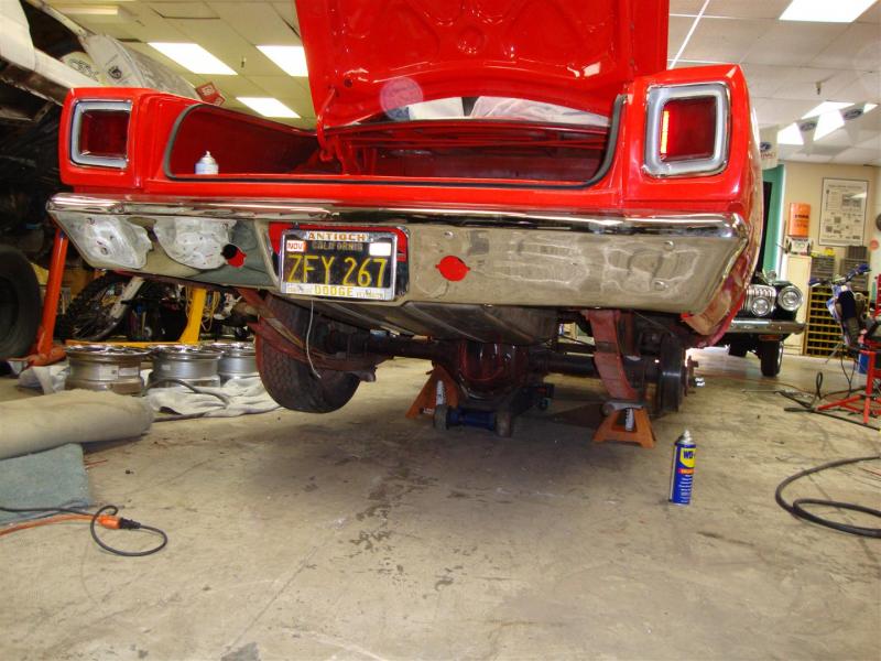

Pics came though just fine .. nice looking RR
Man Meep that Red really pops like neon in that pic .. sweet brother
D575 that's really sharp

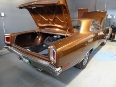

Looks great to me dvw

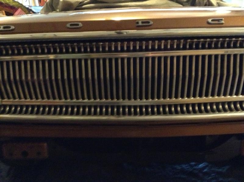

Sorry not a great picture.

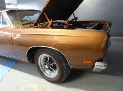

Nice car DVW. Do you know what the color is or who makes it? My 65 Coronet was painted a "rootbeer" metallic probably 20 years ago. A color more like yours would really pop with the white vinyl top.

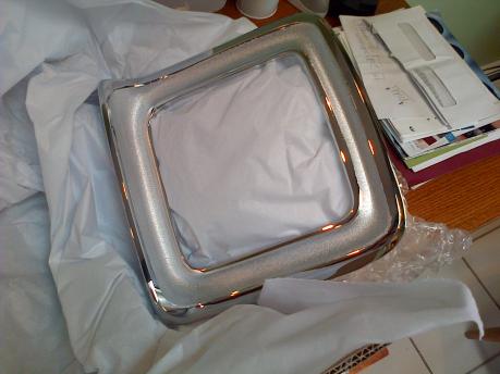

I ended up buy a pair from this place: https://www.monicattichrysler.com/comersus/store/comersus_viewItem.asp?idProduct=4301
Just got them and they look pretty good and seemed to be the best price out there right now for repros. I'll let you know how they look and fit as soon as the weather gets warmer round here and I put them on.

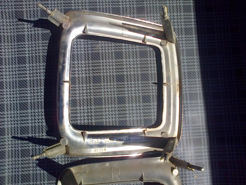

The old ones weren't so bad, the left side is actually very nice, the right side has some small pitts, so when I replace them in a few weeks, I'll post some photos if anyone is interested in buying them.
