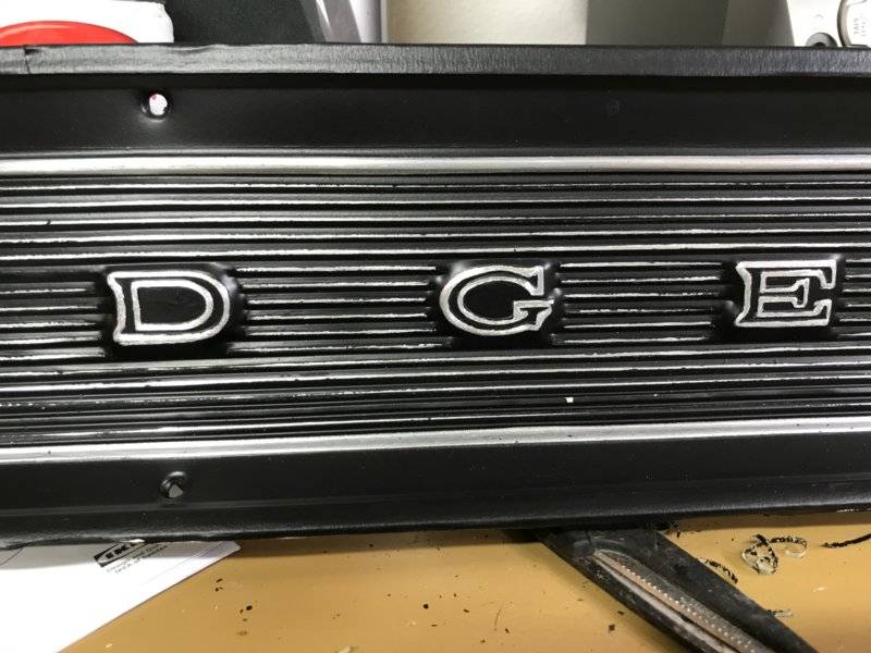

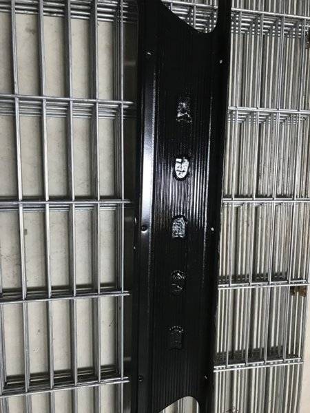

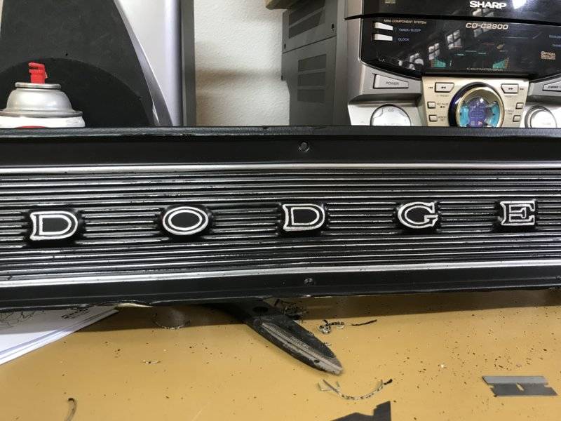

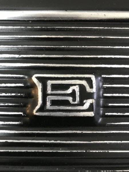

Working on my tail panel. Lot of masking and razor blade work. What size and type of screw for mounting? Pan head #6?

Looking good! Just wanted to make the observation that the outer edge (outside of the screw locations) should be bright, not painted.
I'm not 100% on the screw size but that sounds about right.
Huh. Didn’t see that in the pics I found. I will look harder. Easy to fix. Got a tiny paint brush for touch up.

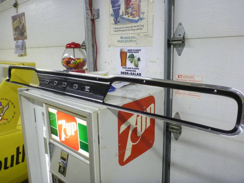

Clearly shown in my resto thread as to how it was finished OE. Screws are about 1/2" long x #6 oval heads.
