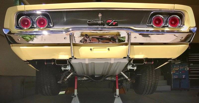

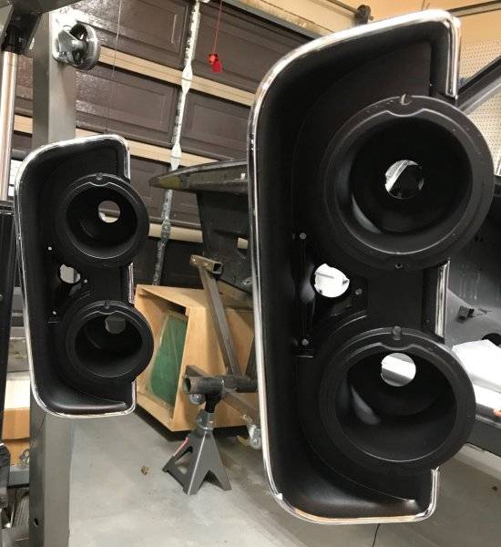

Sprayed mine with Hot Rod Black Matte finish from the Coatings store.
Beauty. Did you mask off and polish the surrounding perimeter area before painting the matte black? Remove the anodizing before polishing? Thanks for sharing.
Yes that's exactly what I did. The inner bezels of the taillight housings were painted with the same stuff. Sprays out pretty good and it's not too expensive.

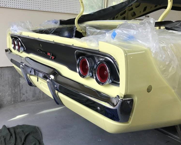

FYI, the only one that has a full anodized finish panel on it is 1970 Charger.
1968 and 69 just have perimeter moldings as shown above

The tail panels on 68, 69 & 70 Chargers were all finished differently. What year Charger are you working on are you working on?
Right, I think the '68 and '69 moldings were chrome. No need to deanodize.
The end pieces are chrome diecast metal. the upper / lower 2 long mldgs are anodized aluminum pieces

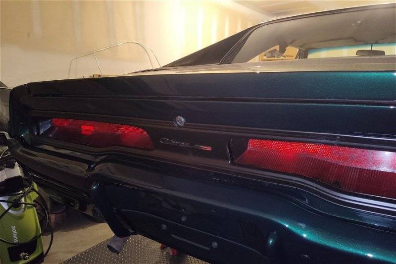

I thought I mentioned it, but I might've overlooked it. I have a '70. I began working on the finish panel today. I can say the best way to remove the black paint (and orange, and blue, lol) is with acetone, but this won't remove the anodizing. I started using Easy Off oven cleaner to begin removing the anodizing. Fine grit sanding will be next and I'm not sure if I'll paint the whole thing SEM Trim Black or mask off the middle strip and polish it up. I'll post some update pics tomorrow.

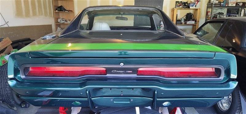

It was a pain in the ***. The original finish on these panels was bright-dipped anodizing. Thus, they can't easily be polished if they're oxidized or worn-looking, you'll need to strip the anodizing first. You'll wear your wrists down to nubs before you sand off that anodizing, then you'd need to wear your elbows down to nubs polishing the now raw aluminum back up. When I tried simply polishing the existing worn-looking, mottled panel, some areas got shinier but others stayed mottled. I tried spraying on Easy-Off oven cleaner as I've used that to strip anodizing from RC car parts for years, but it didn't get the results I was hoping for. It still didn't look good.
I basically said to hell with it and sanded it with 320 grit to scuff it up and sprayed it with SEM Trim Black, I am going for a more mean, goth look with my Charger anyway.
I have a spare finish panel that I can use at some point in the future if I change my mind, but the middle has holes drilled for an R/T emblem and my Charger is a 500.
