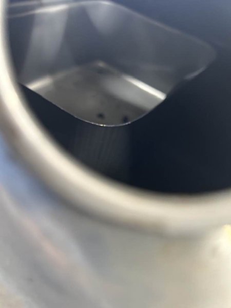

Warning EFI Tanks Inc , if you are making north of 600 hp, this fuel pump baffle/reservoir will empty at Wide open throttle & there are ONLY three 3/8 holes in the bottom of baffle to take in fuel to supply the pump, they are ONLY about .050 thousands off the bottom of the tank, well this explains all my fuel problems, I did do a fuel volume test before I took it apart & it confirmed this reservoir was running out of fuel, what REALLY sucks is now that the Charger will be fixed after 5 trips to the track, the TRACK is gone now GRRRRRRRRRRRRRRRR lots of wasted time & money FML

I have been fighting starving for fuel on the big end, done many test & changes, I found this today, I have a long drill bit going to drill a bunch of holes in the sides of the baffle, will use a magnet to get all the metal out of the tank. I have the biggest baddest fuel pump they sell :)

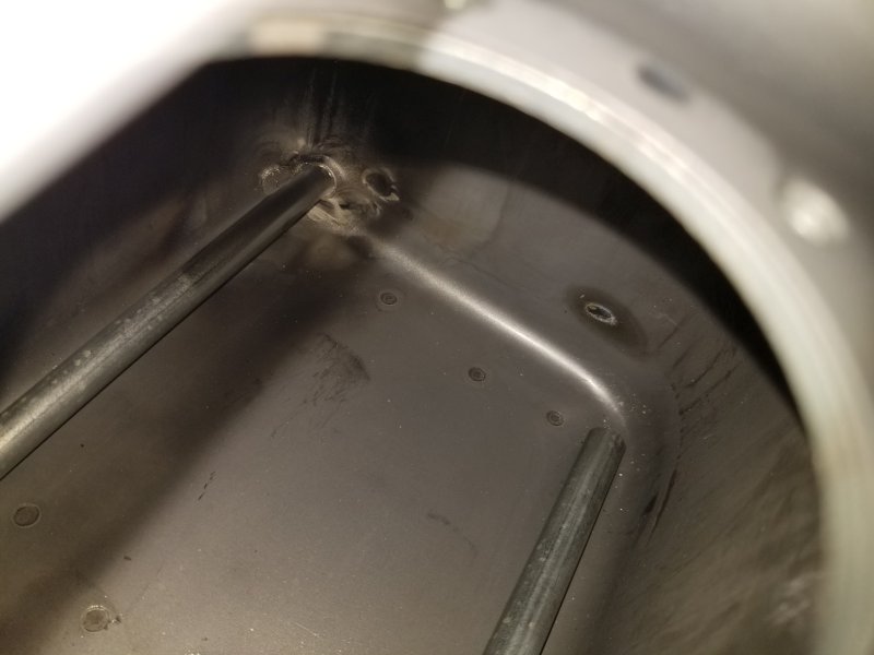

Newer ones have tubular inlets for the tub that are in an "L" shape so it can fill under g-force but not empty. (unless it splashes over the top of the tub).

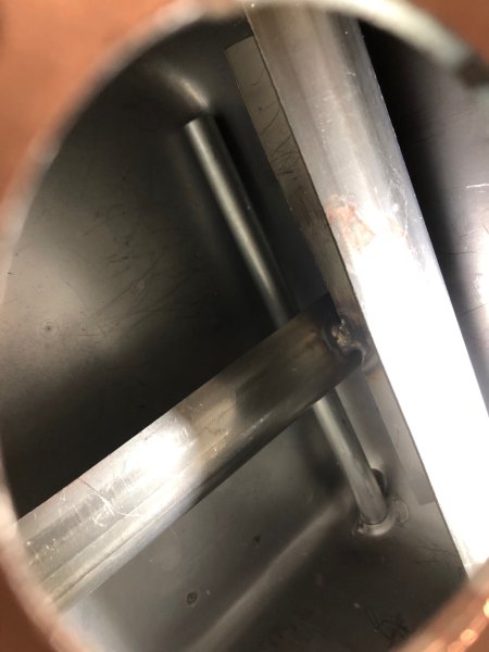

I added some baffles made out of exhaust tube but at the bottom of the bucket you can see the tube which fills the bucket. There's another tube like that on the opposite side.

Yeah, peek in there and you'll see if there's tubing or not.
Mine has two that enter on opposite sides of the baffled area. '68 Plymouth model.

The half tubes slid in from the filler neck hole.
I held the tig torch with my fingertips through the same hole and used filler rod through the sender opening.
It wasn't easy. (which is why the welds aren't pretty)
