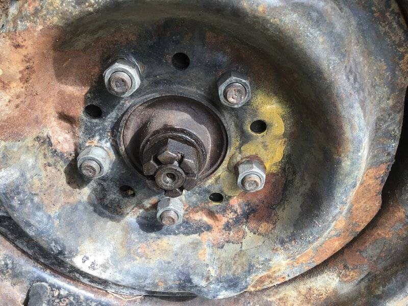

tapered axle nuts-right and left handed?????
These? 1964 and older. Right hand threads only.
Thanks I figured as such but admit I always throw the tapered axles away but running out of 65 up 8 3/4 rears! Now I need the darn stout hub puller!

Took me 4 months to get one off, not kidding. Had all but given up and then we put the big torch on it and poop, it came off. Not certain I learned anything from the experience. I hope yours goes better
I got to get the car rolling as I have a guy coming Fri to look at it with his trailer. I had to drag it off the trailer to unload it when I got it. Local mechanic in this 1 stop light county gets $95 / hr shop rat, and he would have to drive out to do it and he just has a flunky for a mechanic! No doubt the shoes are stuck solid to the drums, sat out since '85! Maybe I an borrow a big puller from O Reilly!??
Parts houses don't carry the big heavy duty pullers to do the job. I found a used one on flee bay.
Sounds like you're pressed for time so maybe removing the wheel, back off the adjuster a bit, take a big hammer to the drum and see if it breaks loose.
