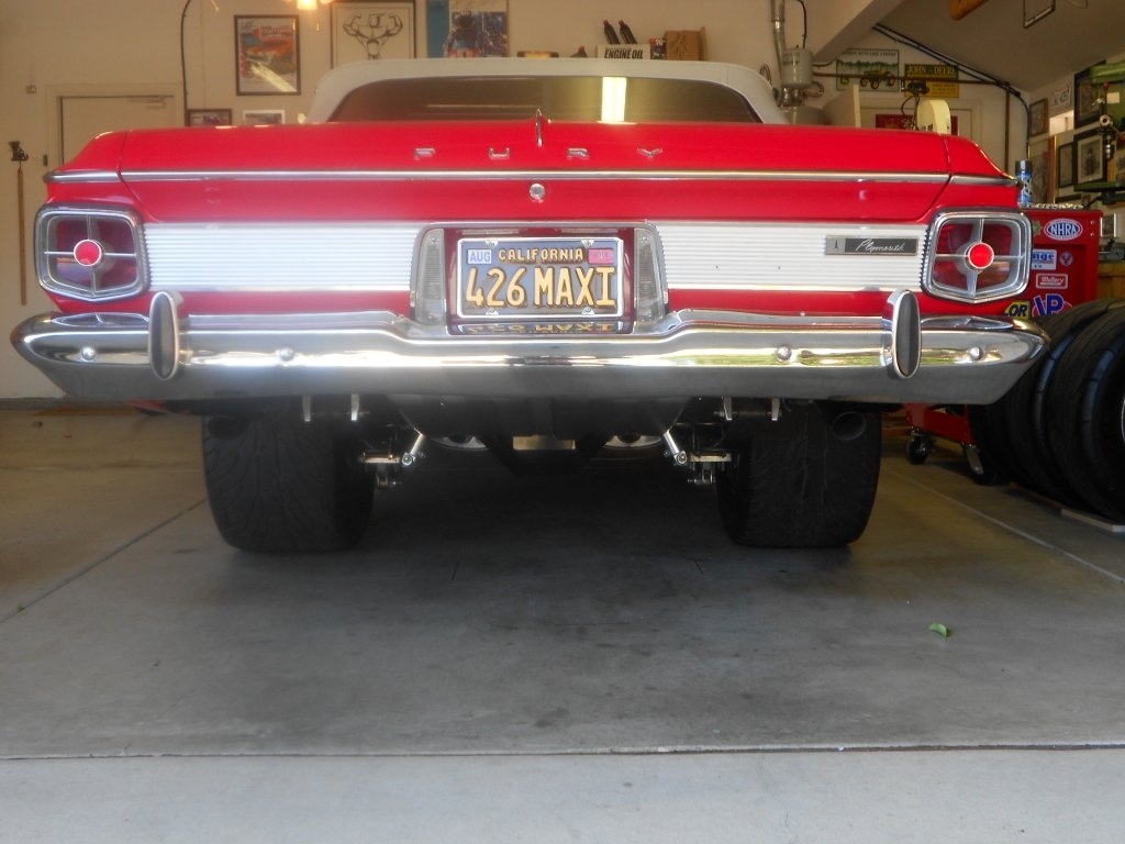

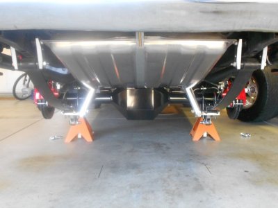

I went a different route and installed a Moser fabricated 8.75" narrowed housing and axles, along with a spring relocation kit and mini tubs. The link to tooltopia that 64 Bel posted looks like a good deal.
Hmm.....had a look on summit's Website and was onl able to find Moser rear ends for 65 and later Models. Which one did you buy?
....you managed to confuse me....lol...thought it will be an easy swap....damn
I purchased the rear-end direct from Moser Engineering. They build it to your specs after you fill out their form. I wanted 12" wide wheels and 15" wide tires which necessitated moving the springs in 3" per side and mini tubbing the inner fenders for clearance. Lots of fabrication/welding. Also added their rear disc brake kit.
