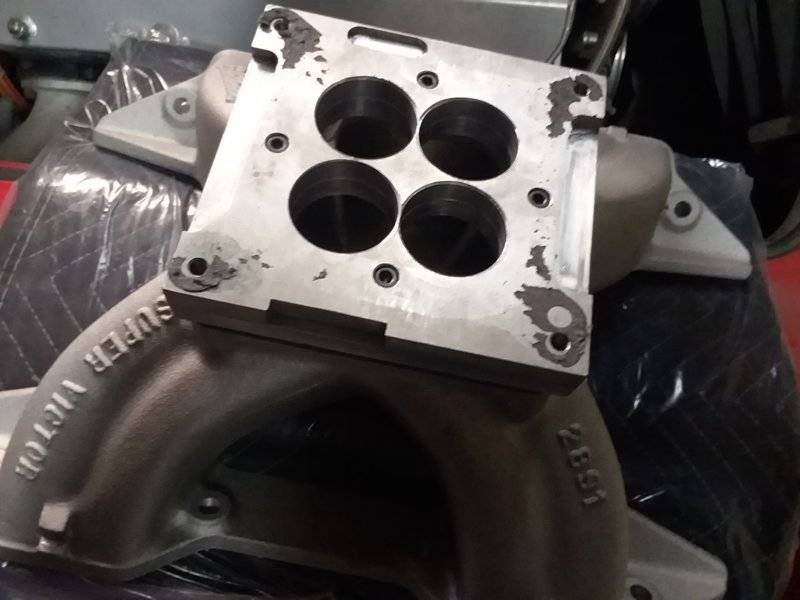

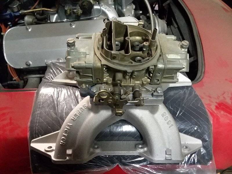

Can you run a team G 440 intake on a Victor Max wedge headed 440

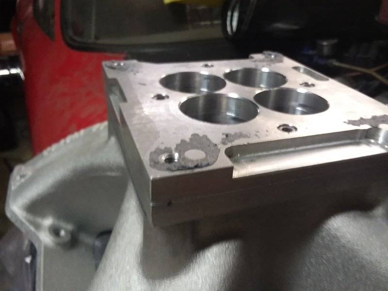

Good job 33 IMP!my team g has had the bumps in the ports removed, and a little further rework. It now runs better than the original torker I had on before.

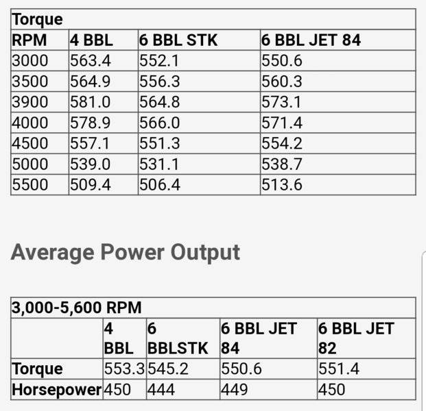

Here is one of the articles on 6bbl intake and carbs vs 4bbl.6 Pacs work great when you work the issues out of them. I got my 6Paks to work really well.
@IQ52 has achieved with the 6bbl atop a stroker. Also since I am going for well into 6XX torque and hoping for 600HP, using the TF240s, that all goes well with the 6bbl setup.I read that a lot.My best set of 6 Pak carb's were '70's.
As you can see I'm not worried about Hood clearance I just wanted to try a team G just to see how it worked but if it's not going to fit I'm buying another Victor intake for a 4150 series carbyou would be better off with a Edelbrock Performer RPM at minimum to take advantage of those Victor Head's, Super Victor intake is the perfect match for your M.W heads but I understand about Hood clearance, that Team~G really isn't a Good manifold, here's a write up they did on 14 deferent Manifold's including Team~G

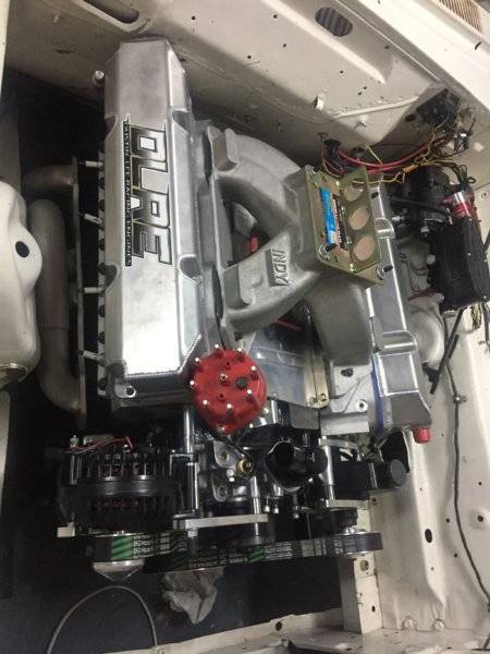

I'm Running the 4500As you can see I'm not worried about Hood clearance I just wanted to try a team G just to see how it worked but if it's not going to fit I'm buying another Victor intake for a 4150 series carb

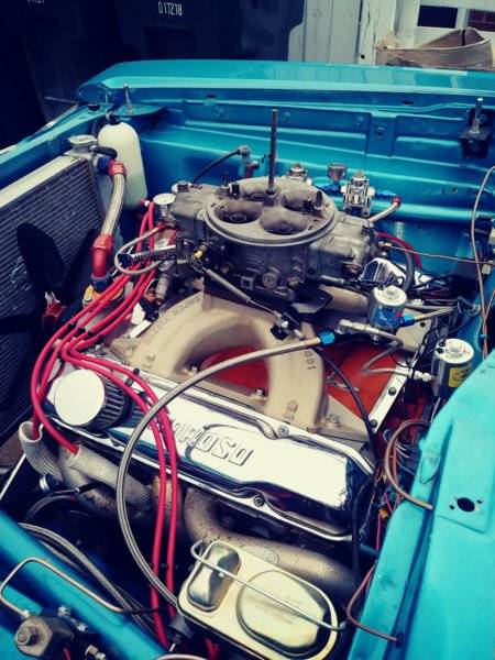

Hey friend,I'm Running the 4500
Indy intake with Victor Max Wedge Heads :
View attachment 681534 View attachment 681535 View attachment 681536
Yes Sir 500 inch Mopar Baby !! LolHey friend,
IS THAT A NEW MOTOR ???
Not exactly true. The team G can be moded pretty easy. I reworked one (flow bench tested) , along w/ a torquer 2 . Both flow about the same "325" range now, with only about 25 cfm scatter between the runners. The team G has a huge plenum, and works well on my 505" wedge. They both will support 600 h.p. , but I run the torquer 2 because the team G is about 1/2" taller, and everything is set up for it on my car.you would be better off with a Edelbrock Performer RPM at minimum to take advantage of those Victor Head's, Super Victor intake is the perfect match for your M.W heads but I understand about Hood clearance, that Team~G really isn't a Good manifold, here's a write up they did on 14 deferent Manifold's including Team~G
