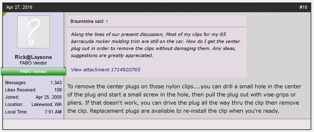

OK, I got the rocker moulding off. I see all my clips are new and didn't break. Now, how do I get them off? There is a push pin in the center that tightens the hole as you push it in. They are all flush with no way to grab and I can't see how to get them out from behind.
Surely I don't have to place a screw in it to be able to pull each pin out?

They don't slide off of the pin?
