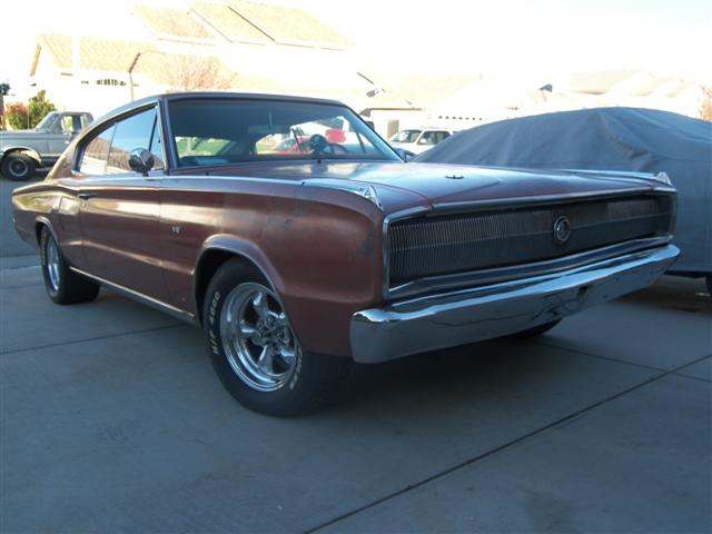

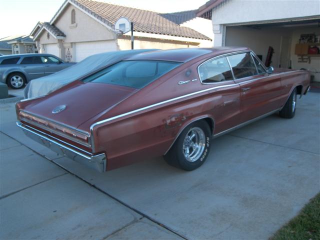

273 engine 007 (Small).jpg273 engine 006 (Small).jpgYes sir i agree...Its like a big dude with little feet "just looks funny !"
if they fit... i would run 15x8 in the rear and 15x7 in front, its going to fill the wheel well better !!
maybe someone could post pics ??
