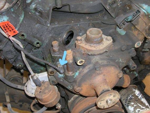

The one on the left "brass with caps" would be your best bet. The other is the radiator hose connection. Pretty sure they don't have one for that. Unless you are talking about the one with the blue plug in it. Typically they are more under the compressor. And its a smaller sender.

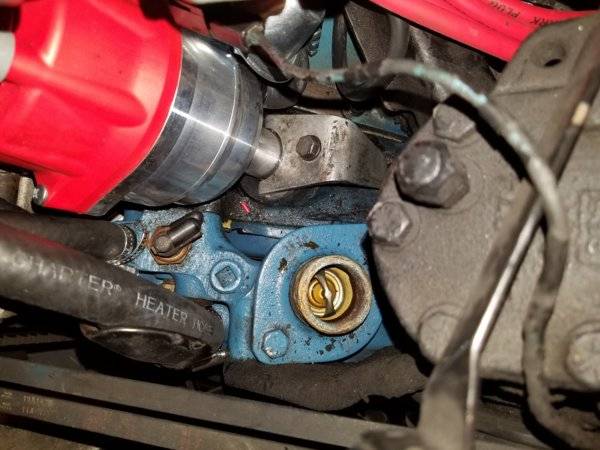

Remove the pipe plug to the left of the T-stat housing and use sender that came with your gauges. Not a very good pic but here's mine.
Yes, both of those will work. The old sensor location is your best bet. If that pump is old that pipe plug may not come out at all without taking the threads with it.
Size of your mechanical sensor threads will likely make the case for the location.
I was able to get the blue pipe plugs, just left of your thermostat, out on my car. I run my mechanical gauge in that hole & still have the factory gauge hooked up with the "L" push-on connector in BeepBeepRR's picture. In my case, the mechanical sending unit was maybe 1" deep & only had enough clearance in that hole. The necessary adapters came with my gauge.
