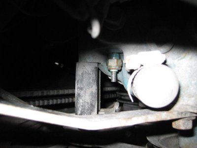

Mine looks like it is on the alternator side rather than the compressor side and does not appear to have any clearance issues. It has the connection that slips over the threads. Am I missing something here or has mine been moved from the original location? There seem to be a lot of options for mounting a temp sensor. There are two additional plugs near where mine is mounted. I have tried looking in the 67 parts manual for the temperature gauge sending unit under the electrical, cooling, motor, and miscellaneous parts sections and can't find a part description or number anywhere.
