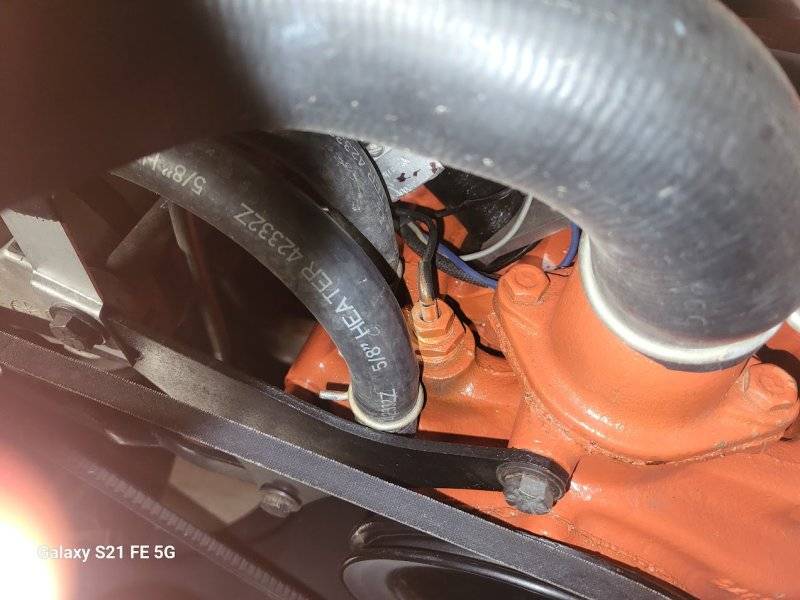

On w/pump between htr hoses & alternator.

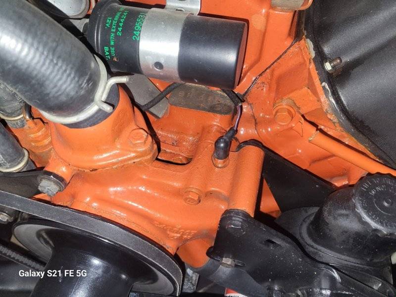

My stock sending unit is drivers side, but its a 66. 67 and later is pass side facing forward like posted above . It will have a single Violet color wire with a 90degree push on connector
I also run an aftermkt mechanical gauge and it has its own sending unit mounted in the water pump hsg near the hear hose fittings

Thanks. I don't have anything on top of the water pump that is electrical.

Thats why I said post some pictures. That sender is right in front of your face.

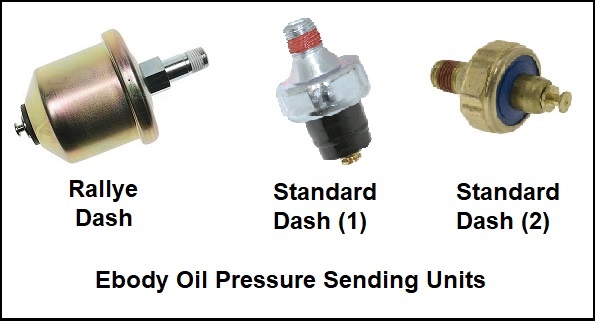

The oil sending unit on the 440 block is at the rear, not the front, of the engine, just behind the intake manifold, and the top of the engine block, just in front of the transmission.
