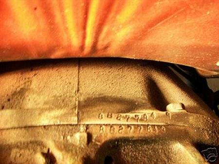

Look for the VIN up on the top of the bell housing. This is where 68 model year cars were. Not sure when they started stamping the pad for 69.
68 example:
I've checked that area and there was nothing.
