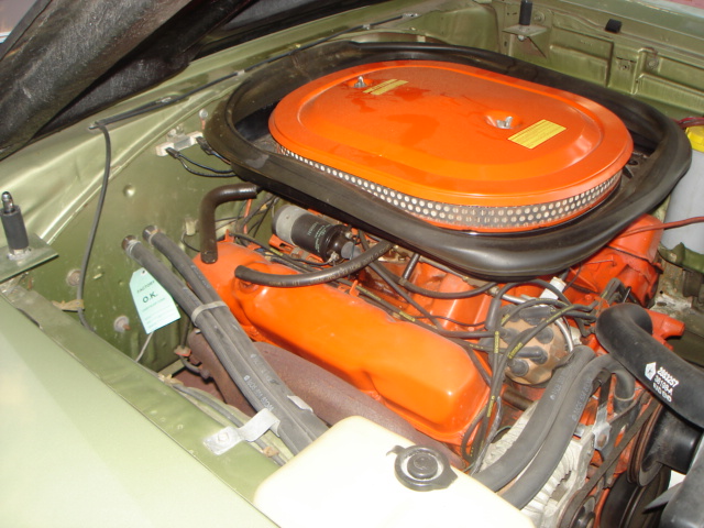

wrong, all the earlier than 72 had black wires with orange letters on them.
you got bthe wrong wires orange are for 72 and later.
heres the correct ones.
this from a survivor 1956 mile unrestored, untouched a12 rr.

Thats nice of Mopar, they tell their dealers that 1971 and earlier are orange wires, and then sell them that way. BIG mistake on Mopar! Even if they were orange, 2 of the wires don't fit and they know about it! Now I will hunt down Black wires!
