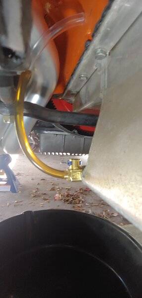

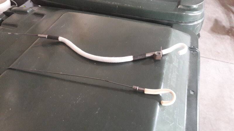

So my 66 Coronet Hemi tribute has a 492 Hemi with a World block and Moroso deep sump oil pan (sticks down ever so much lower than the K-member skid plate). Took out the dipstick to check the oil, was low, looked like just a bit was showing on the stick. Put in a quart. Can't get the dipstick back in, it's hung up on something, goes in about 2/3 and gets stuck. Decided to change the oil, emptied about 5 1/2 quarts our of the pan, so it was low if you believe the stick. Put back in 6 quarts. Finally got the dipstick to go all the way in, pull out, but no oil shows on the stick. Talked to the guys at Mancini's, bought a hemi dipstick. It's WAY different than the one from the car, see pics, the Mancini is on the top. It only sticks down from the flange about 3 1/2 inches, vs. the original one about 10. WTF is going on? When I get the original one to go in (with a bit of force), it shows no oil on it. But there is 6 quarts in the engine, and nothing on the floor. I am at a loss. Any help please?
