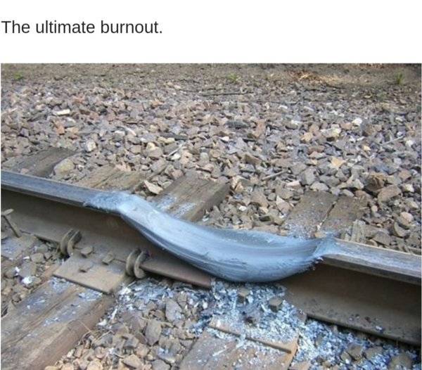

Is that really caused by sheer power and torque?

"The crew "parked" the train for FOUR hours. They "tied down" the forward locomotive. I'm not a "train man" but somehow #2 and #3 locomotives were apparently still in gear, and in 4 hours, this is what happened to the rails. Maybe someone has further information on where this happened?"

This is something that doesn't happen instantly. Those drivers were turning for some long time while the train was not moving.

It happens faster then you think ! Trains are extremely heavy sometimes it takes quite a bit of umff to get it rolling . The guy s running didn't realize they were spinning I guess (train's are very loud! Guy at work tore up the train track like that once he was fired on the spot ! He did it on purpose though thought the sparks at night would be cool ! Couldn't see how fast the metal disappeared ! Less then a minute I'd say
Those pictures are almost twelve years old, I don't remember the details. The guy who sent me the picture originally mentioned that it was a 'distributed power' train, meaning the train had engines in the middle or tail end as well as the usual front. The secondary unit is controlled by telemetry from the lead locomotive, and in this case a couple things went wrong. While the train was parked, apparently the middle or tail locomotive kept on at power. Of course with over 100 rail cars with brakes locked up, it went nowhere. However besides that malfunction, it still shouldn't have happened because the wheel slip indicators should have dialed back the power as soon as they started spinning. Seems like a combination of more than one problem caused this.

If this happened in less than a minute it must have been at rpms that would be hard to account for given the train is not moving.--Just saying---

Yes very high rpms . ,more then likely guy was an idiot doing it on purpose before he quit!

Most freight locomotives are speed limited to about 65 mph, you won't get more than a 500 rpm. wheel rotation with that (42" wheel).

The term "high rpms" may be misleading in this case? Maybe indicated mph vs --not-- moving would be better.
