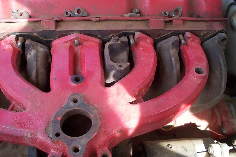

Need more info. There is nothing such as a thermal choke pull off. Are you after the choke pull off (vacuum pod mounted directly to the top rear of the carburetor with two screws, with a vacuum hose coming off the back)? Or are you after the choke thermostat (metal box attached to the exhaust manifold with two bolts, with a pushrod running from the box up to the choke lever on the carburetor)? Do you have the original 1967 exhaust manifold, or has it been replaced?

hi slantsixdan this is where i had to download but,there it is.thanks man..Barry

OK, that works. You've got a '73-up exhaust manifold on the car. I will send you a PM with choke info.
