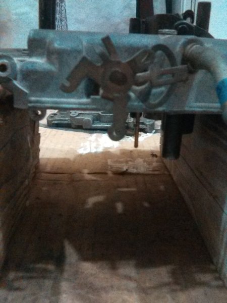

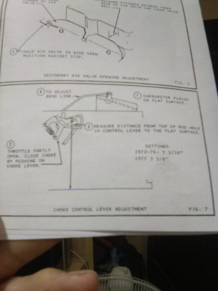

Need missing spring as shown in carb kit diagram photos #1 and #2 (or if a forum member can provide a source for such spring that would be nice as well). #3 photo shows my '72 340 6139S Thermo-Quad where the missing spring should be on the left hook and on the bottom hole. Then #4 photo shows '71 with small spring; #5 photo shows '72 without spring but with spring slot now replaced by a spring hole; #6 photo shows '72 with large spring. Hard to say what is a factory spring size and what is not at this point. Thank you.

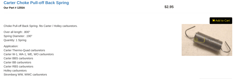

Also try Mike's Carburetor Parts: Carter BB Choke Pulloff Spring 66-10
Description is for Carter BBS, but it is listed under Thermo-Quad parts too.
