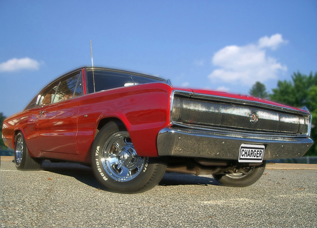

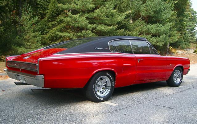

Hey Gpuller, could I see some pics of your car to get an idea of how it looks and sits with 295's?

Here's a couple of mine with 295/50's...
I have better shots, but they're on another puter.
That looks really good!Thank you.I like the stance your car has.What back space and width are you running?
On mine the rear is a BFG 295/50/15 mounted on Cragar 10" rims with a 5" backspace (-12mm offset).
