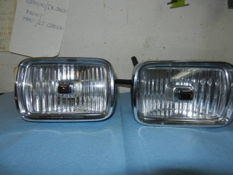

I would like to share a new experience with you regarding re-chroming. We all know how expensive and time consuming this can be but there is an alternative that is quite remarkable. A friend of mine dropped off a set of 67 Barracuda parking lights to have the reflectors buffed in an attempt to restore them. Of course, the inner chrome was flaked and tarnished to the point that they would need to be chromed, but he did not like the idea of trying to remove and replace the 1157 light sockets. I purchased ( for $12,00 ) a piece of chrome, not silver, wrap off Amazon and here's the results. He was so pleased, he purchased a larger piece and the front bumper is next. This stuff is tough and has a brilliant shine ( just like chrome, cause it is in a way) and if the bumper gets scuffed we'll just replace the wrap.

Guess I forgot to mention that the car has LED bulbs front to back. Heats not an issue.Besides, the flat black wrap on one of my cars sits in the sun for hours after use and the wrap neither blisters or bubbles up. Hood temp is probably in the 250 degree range in that scenario.
