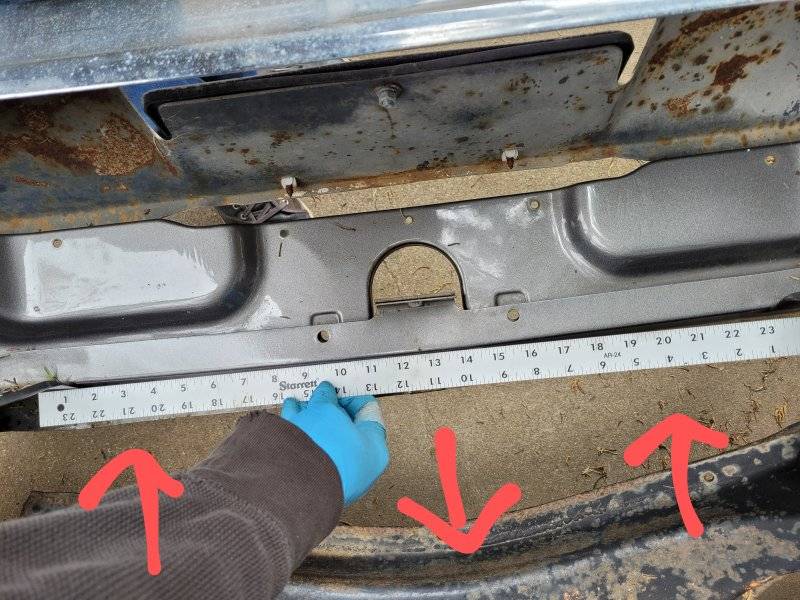

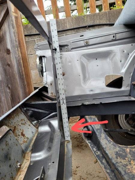

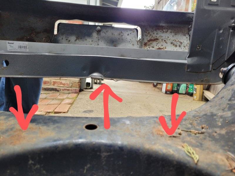

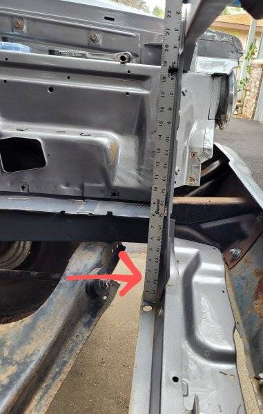

Bought a 66 satellite rolling shell years ago and been slowly putting it back together, tried to mock up a new radiator today and I think my core support is out of whack. Having trouble finding good pictures to confirm, but I'm guessing it's supposed to be flat, and the lower support should be 90° to the core support face?
Somewhere in the past, I bet somebody hooked a chain around that lower part, and dragged the car around or up onto a trailer.
