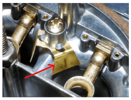

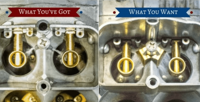

Here are some off site videos of the plates in action.
There's a number of videos on Youtube of people testing the Powerblast Plate. One guy handy with metal fab even did a video making a replica of it, and was surprised at the amount of increased throttle response just by adding it. The majority of the videos I saw claimed a noticeable difference in throttle response/bog elimination. Not sure how it would translate to added HP, nor did I see any videos really claiming more. Is it worth $40? It's cheap enough that I've considered it for sh*ts & giggles.
I tried them on a few carbs and they did not do much. One car developed a stumble off idle and a lean cough so I took it back off.
They may improve throttle response on some engines but I don't see how they can make more power.
If you can tune an accelerator pump save your money.
It can only lose power as it impedes airflow.
Could possibly improve a poor pump shot, as mentioned.

Are you talking about the accelerator pump Gizmo or the plate that goes under the carburetor?

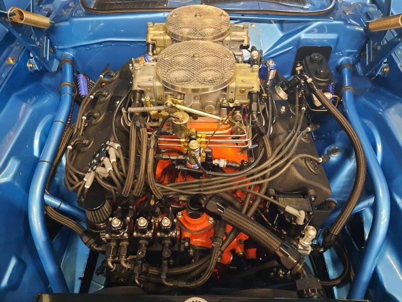

They don’t increase air flow so they’re not going to make more power. On a Ill tuned carb they may help throttle response. Nothing pump shooter and pump cams cannot fix. Just a bandaid IMO. I build and drive 1050 cfm dominators on the street and don’t need em..
Same here, but with two 1050's.
