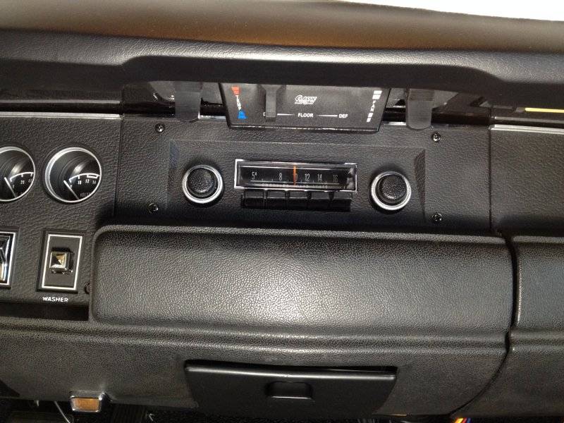

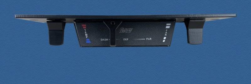

I would be interested in the full kit for non-ac cars. Has anyone made the swap? How does the controller look in the dash? Does it cool and heat well?

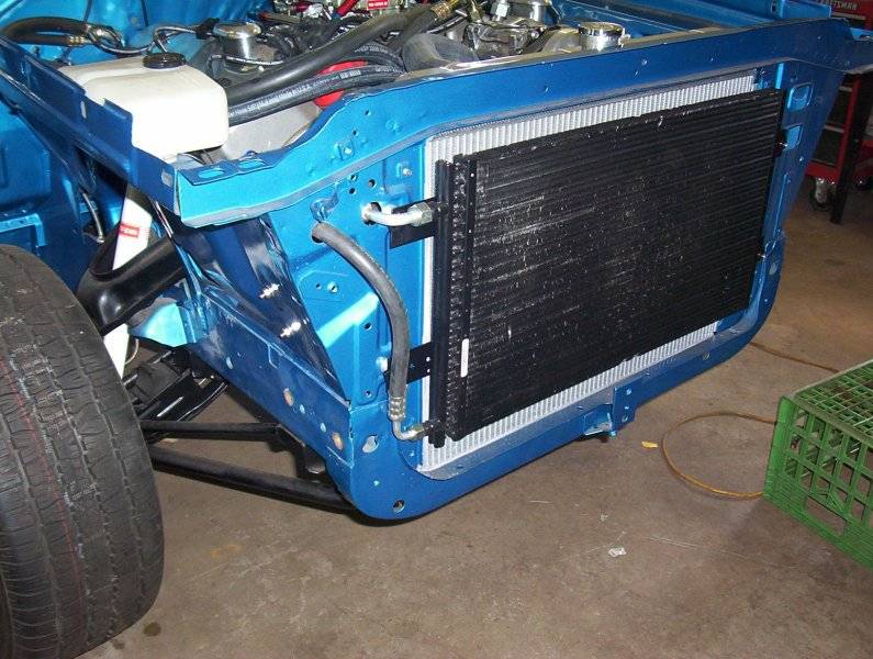

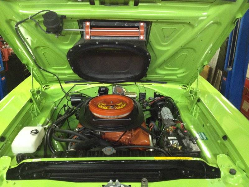

I have the Classic in my 69 Charger and it works great. Mine is the older version that I ordered at the start of my build. The newer ones are better yet. I did buy it with the universal condenser and hose kit. So I built all my hoses to fit to my liking being I was installing a Hemi.

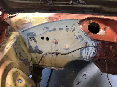

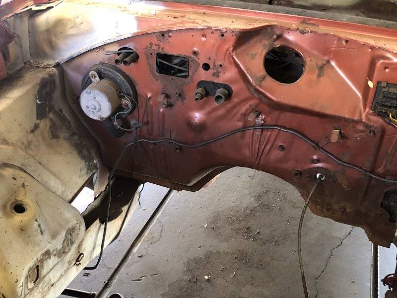

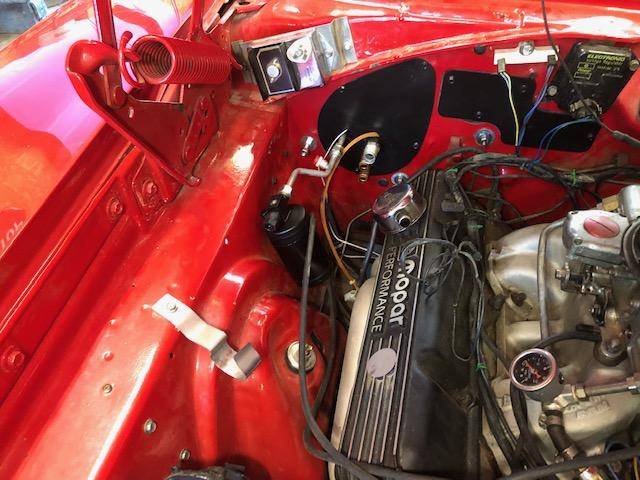

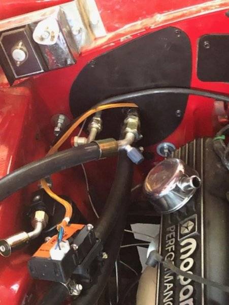

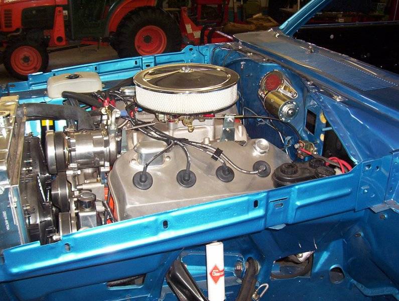

I put CAA in my red car, an original A/C car. They provide block off plates for the firewall holes that the original A/C components used. To me, it looks like what it is...a "Band Aid".
For my other Charger, I welded in a NON A/C firewall section to make the CAA installation look cleaner when I eventually install a kit.

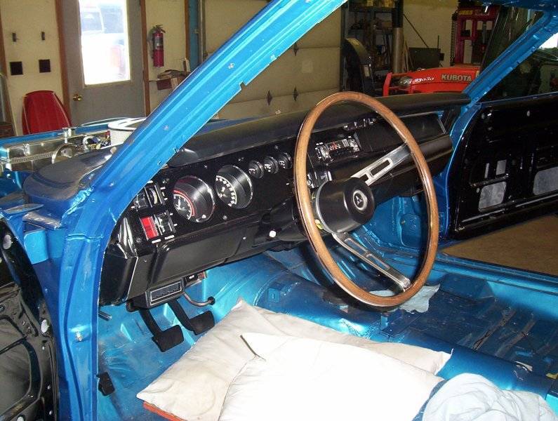

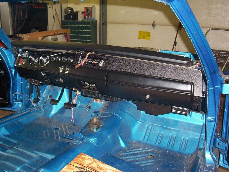

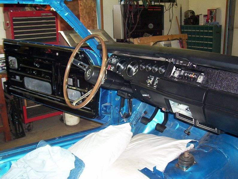

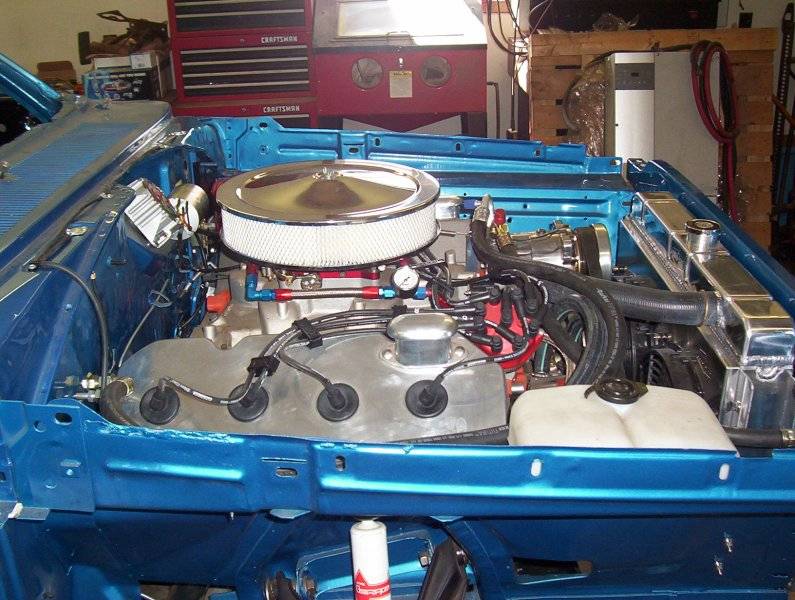

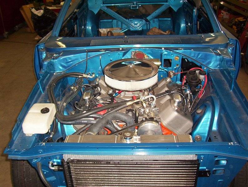

My car was a non A/C . Here are some earlier pictures. I changed a lot finishing things off.
I used the Classic Air "Perfect Fit" system that I bought and installed in 2015. It's been ice cold and has worked great since then - no issues at all.
I see th3 Classic Auto Air HVAC box occupies the real estate under the center of the dash - where do cables for the floor vents go?
Floor vents?
There are vents along the middle. No cables needed there.

My 70 Road Runner has Classic Air, and the right hand side fresh air vent has a block off plate and is partially blocked by the heater. I believe this will be the same on any B-body.
For years, I have had an extra drivers side vent that I could maybe modify to fit on the passenger side. The vent would need to have maybe 1/4 or 1/3 of it removed and contoured to the shape of the heater control box.
I have never yet gotten a chance to try this project, so I'm not sure if my idea is genius or stupid. I haven't looked at it closely enough to see how practical it is and/or if the door in the vent could even work. But I figured I'd share my idea just in case it inspires someone...
