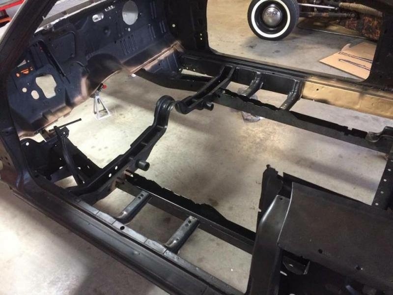

I am about to stick my floor pan in for the last time and weld it in and remembered an idea I had about cutting out the torsion bar mounts and welding two large pipes for the exhaust to run through.
I want the car low and that should help that a bit. Crossover might be an issue.
I know I have seen someone do it on here, it was only pictures, but cannot seem to find them now.
The car is a 68 Charger RT with a repop cross-member I already replaced, and it will be a coil over conversion as well.
Thank in advance!

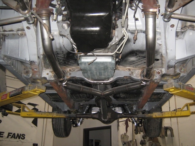

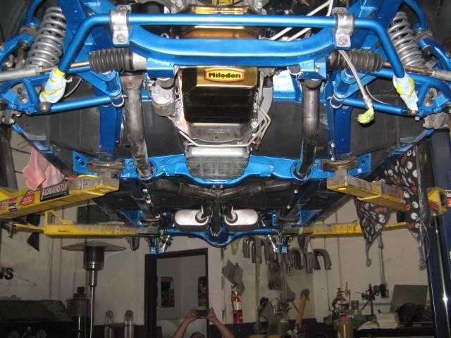

Here you go Brother! This was possible because I don't have the torsion bar suspension any more. This is an alterktion system
Yes! This is exactly what I was thinking! What size inner diameter pipe did you go with? Im thinking room for 3.5" should be sufficient.
Im for sure doing it now.
