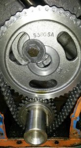

I have a 1973 Charger with a 400 (single bolt cam). I just replaced my timing chain and gears with a double roller. I did not touch the cam. When I torque back down my cam bolt should I use thread locker? If so blue or red?
Should I use my original bolt or should I replace?
