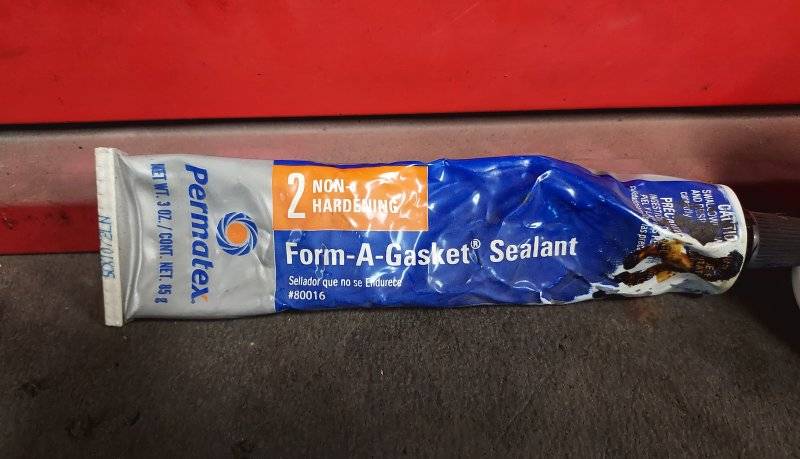

Non hardening #2 Permatex is great.

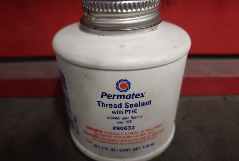

Been building engines, transmissions, and axles for 45 years. Threaded connections get white Teflon sealer. It's cheap, it works. In fact the large tube I have is at least 15 years old. I know some will not believe and scoff. It will seal brake lines as well. Never assemble stainless brake lines without it. Keeps oil from wicking up intake bolts also.

Yep. As an old fire sprinkler guy, I always had a small jug of this stuff laying around - we old school fitters put threaded
pipe/fittings together with "tape and dope" - and honestly I usually just used the teflon tape on sprinkler pipe, so I wound
up with full containers of this stuff laying around.
I use it on header bolts, always have. Works fine, nary a leak.
Oh, about just using tape on sprinkler pipe:
I got away with just taping pipe joints for decades because I'm fussy with thread depths on fabbed pipe...
Doug

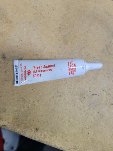

I use the Permatex 59214 pictured in post #2. It is made for this purpose. Non hardening so threads can be cleaned easily if it ever needs to come apart. I use it on wet head bolts and exhaust manifold bolts. Used it on the exhaust manifold bolts on my 64 poly 318 a few years back. No leaks and working great since installed.
