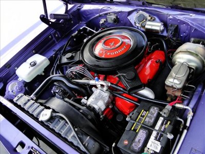

Wait a minute... just found this pic. It's hard to see & this might be an aftermarket A/C unit, but it looks like it is attached to the A/C compressor. I guess it is "possible" if you had a dual snorkle air cleaner that the throttle return spring bracket "might" hit the driver's side air cleaner snorkle making it necessary to attach the spring to the A/C compressor.... Anyone else?
Yep, have the dual snorkle on mine also.......
