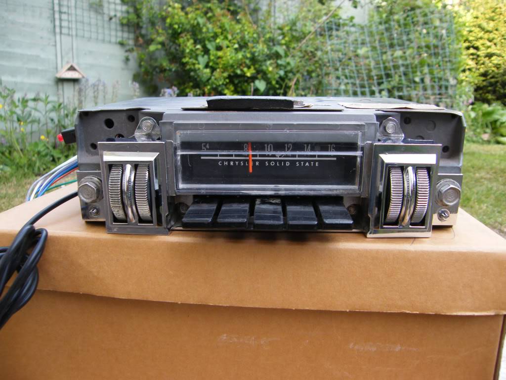

Yep, sounds the same as our Sport Satellite's AM thumbwheel radio. I was putting it back in yesterday, and yes it's 2x screws at the front, (behind the fascia) and 1x nut at the back, towards the passenger's side.
We've still got all the seats out so it's not too bad laying on yer back and looking up under the dash, but you'll need to be a contortionist if you still have the front seats in!
And here's the one I'm referring to, out of the car, just after we'd had it converted to AM/FM/Stereo/MP3 etc
