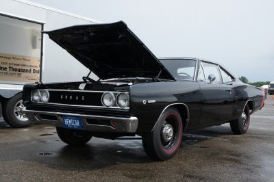

Poverty caps like these. One year only dodge cap.
Matt
