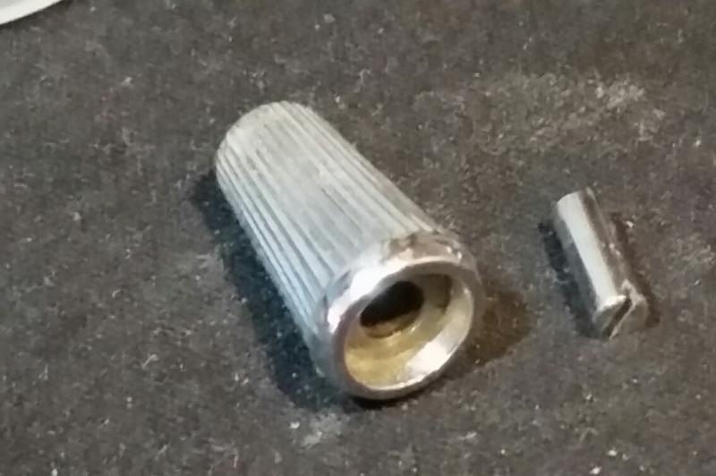

The knob has a special tube 'nut' with a slot at one end for a small flat bladed screwdriver. The nut is placed inside the knob then hold the knob as the nut is turned.

Here's a shot of my spare....been tucked away for about 30 years....
My shaft is out of the clock, the knob was broken off long ago, lol... Thanks kiwi, I see how that part of it works now..

kiwigtx, your my hero!​
i was wondering why my knob wasn't threaded? you saved my *** and i found that little fkr. i saw this spinning out of control and eating up a month of my life i would never get back.
cant believe I found it!! Thank you so much!
I am pleased that I could help someone with my knob picture. :lol:
