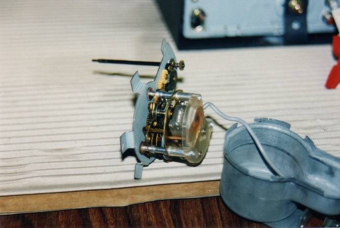

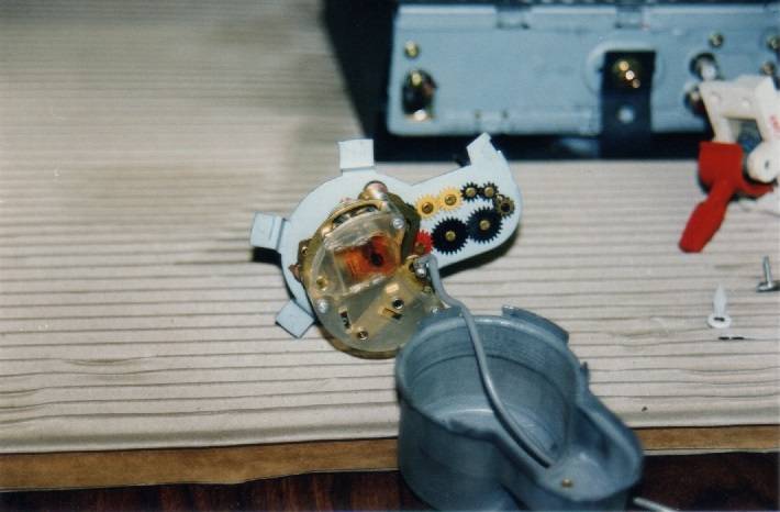

The clock is attached by 3 (I think from memory) small foldable tabs on the rear - inside the Tach housing. It is fixable, and the fact that you were able to pull the clock free, suggests that someone has been inside it before this.
It is not a daunting task if you set out some small tools, and a clean work surface....take your time.
Here are a couple of pictures I took of mine back in 2000 or so....
^^^ You can see the typical tell-tale sign of black - scorched marks where the solenoid coil has burnt up.
Likely happened within 20 minutes of leaving the factory. :rolleyes:
Some may have burnt up after 20 minutes but I think when the cars were parked and no longer driven the battery got low and there wasn’t enough voltage to reset the contacts. Therefore there was enough voltage to cook the coil over the time it took for the battery to completely die. Those coils were never designed to carry any current for more than a few milliseconds.
Kind of an important feature of a clock that wasn't built-in to them. :lol:
